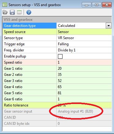

Hello I found the problem why not turn higher . with gear sensor input I have an analog cable lock attached , but it was not active (see picture) .
When I put this out , has all works as it should .
