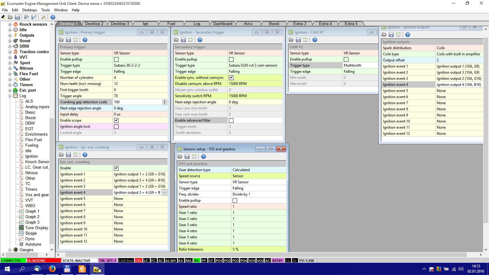

the engine does not sync.
on the first cam we have 2 tooth and 4 tooth, on she second cam we we have only 4 tooth.
trigger log.emuscp

Make first a scope of your trigger :)

DT-GT42 wrote:Make first a scope of your trigger :)
in the post is a trigger log as atachment

from the scope it looks like your edge setting is wrong on the crank trigger!
