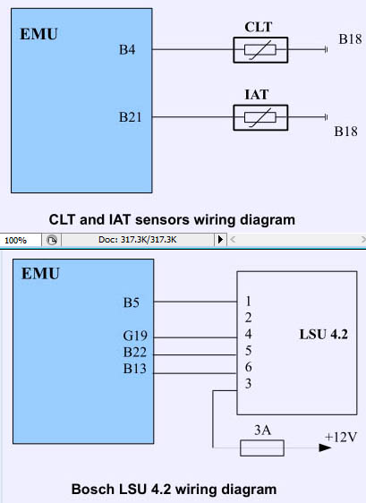

CLT is wirend on one side to pin called "Sensor ground" and the other end to "CLT" input....... after that you should select the correct calibration and it should somehow read your temperature. Some "finetuning" may be requered .... not every time.
WBO works like in the manual, nothing to say more about it. Connect it, meassure the Rcal, put it into the calibration , select you have WBO (not narrow band) and thats it.

I enclose pictures.
I am not mechanic or tuner but to see how it is wired I am sure "the right pins in the plugs".
Each wire is labeled for easy checking.

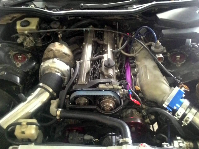

It is messy when it was being wired.
Now it is quite clean engine bay.
ECUMASTER installed inside dashboard.
I enclose picture with ECUMASTER installed (no messy wires).
"i assure you EMU are far better and easier"
I bought it for much better price comparing to HKS and LINK installed in my other cars.

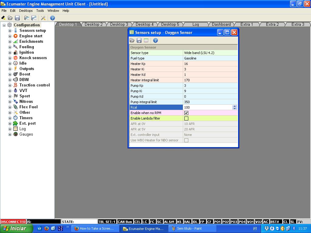

lets start with the WB problem, put these settings on you file, for Rcal use the value measured with ohmmeter on your sensor.
