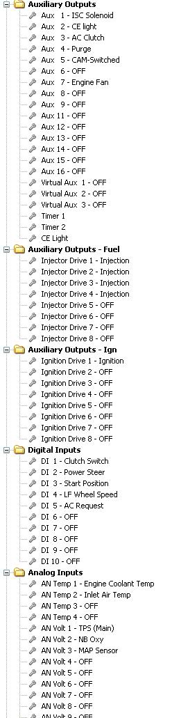

1. It where nice if the software only offers inputs and outputs to assigne that are not already used.
As Sample: Its possible to assigne analog in 4 to fuelpressure AND fuellevel.Yes there comes a warning window but why they are in the dropdown list?
2. It's not possible to use ignition outputs that are not used for other applications.
3. Think about order the in- and out- puts as in my attachement. I find it more comfortable.

Re: Bugs and Feature reqests
Post by PSI-Motor » Fri Jan 16, 2015 12:28 am
As the Vi-pec and Link? You just klick on assigned outputs on the emu to se everything.
lemmy01
Posts:14
Joined:Wed Jan 14, 2015 4:28 pm
Location:Koblenz/Andernach
Post by lemmy01 » Fri Jan 16, 2015 12:55 am
Yeah i have a vi-pec V88 for my toyota 2grfe engine(in Mr2). So it's possible that i find the tree better because i have worked a a long time with it.
