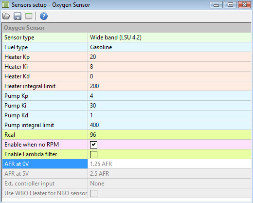

Current WBO setting.
AFR at 0V and 5V are grayed.
Must it be connected before values can be changed?

Use the settings i gave you except for Rcal.
Must be connected and press "make permanent" to save the values for the ecu.

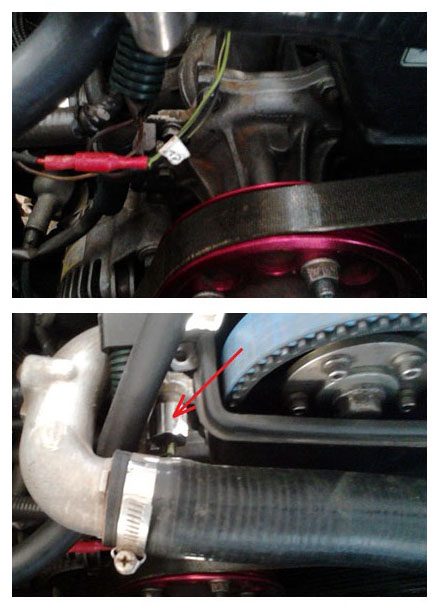

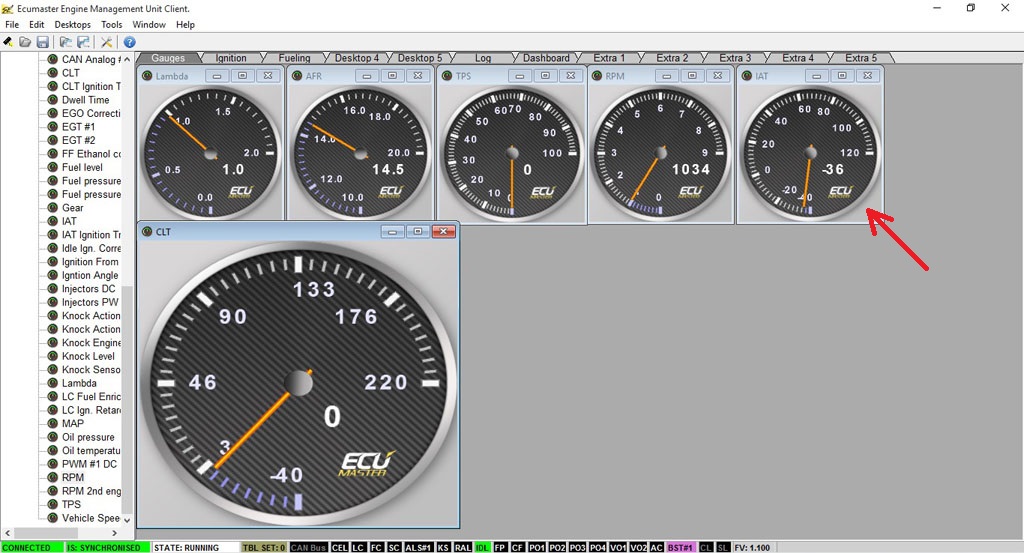

Hi roquete.
Finally WBO working. Thanks.
Still cant solve problem with CLT even CLT sensor changed/replaced with another sensor.
We stretch new wires from sensor to ECU, not working.
What "predefined sensors" to use? Bosch, GM, Toyota?
Now stock/factory 2JZGTE VVTI CLT sensor is used.
Let say "Toyota 1JZ-GTE" is selected.
Any value must be change?
Or could it be ECUMASTER faulty?
Last time I didnt mention IAT sensor.
I bought new sensor from UK ECUMASTER.
(http://rrrshop.co.uk/bosch-air-temperat ... -170-p.asp)
IAT sensor is installed about 30 cm before throttle.
We try all possible options (predefined sensors), from Bosch NTC to CLT Mini Cooper.
IAT never work, just show number -36.
Any suggestion?

Re: Need Help
Problem with IAT and CLT sensors solved by upgrading software and firmware to 1.161 version.
Thanks for helping.

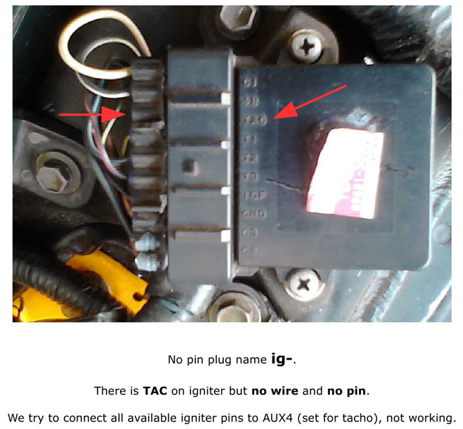

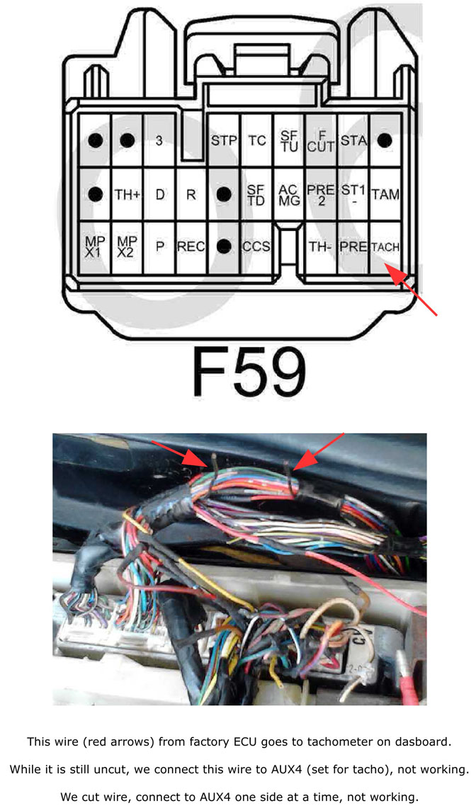

Re: Need Help
Hi roquete.
We do 2 different things (see attachment).
None working.
Any suggestion whats wrong?
None working.
