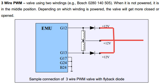

i have the same problem with my 3-wire idle valve. It doesn't respond well in small areas near 50 DC.
Because of that i decided to install flyback diodes. In the old manual it wasn't mentioned to install them with 3 wire idle valves.
In the new manual there is a picture.....but im not sure and need little help how to install them.
Do i understand this sample right ? Can somebody explain how the diodes work in this case and what is the effect ?
Re: Idle stabilisation
Hello!
This is a bug in the software. It is already fixed. The software 1.110 should be available in next 2 days.
Good to know, i hope it will work better. Im fighting with this strange idle valve behavior since some months and always thought that it is because of my settings.
Sorry for the issue
There is new software 1.110 where this bug is fixed
