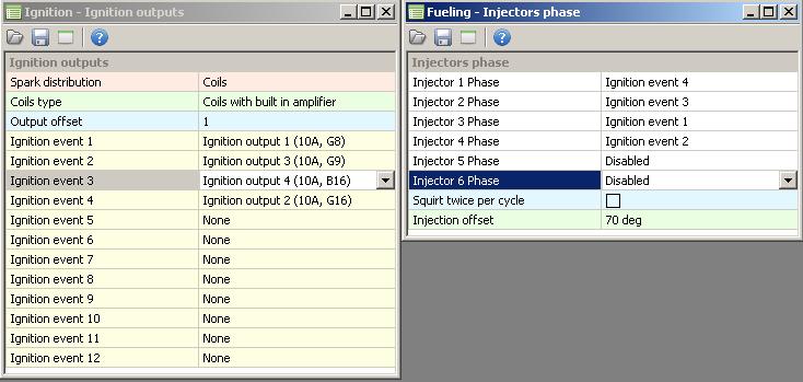

Post by PBU » Thu Nov 27, 2014 8:37 pm
These are my settings.
Four cyl 1342 ignition sequence.
Wasted spark with dual fire Bosch coil connected to output 2 and 1.
Output 2 for cyl 1 and 3 and output 1 for cyl 2 and 4.
Engine is running good.
So when are my injectors injecting exactly ?

PBU
Posts:134
Re: Injector sequence
Post by PBU » Thu Nov 27, 2014 9:16 pm
Kurt wrote:I made a post in another thread.
viewtopic.php?f=19&t=154
IMO, injector timing is poorly implemented with the EMU at this time. It took a test bench and oscilloscope to figure out! There is no advance vs rpm table and it's timed for start of injection instead of end of injection. If it were end of injection and we had a 3D RPM vs Load vs Inj. Adv. table then we could tune for a lot better/cleaner running. This would be especially good with VVT, allowing us to time injection after overlap.
I think you are right.
Maybe an idea for next software.
If i understand correct from my table.
Injector 4 start to inject at cam signal 60° before spark in cyl 4.
If this is correct my settings are wrong.
The ign event should be (top to bottom) 4321 as diagram below.

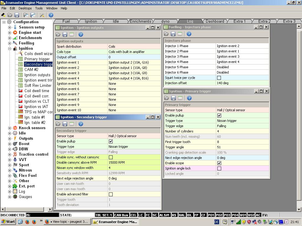

eugen_troll
Posts:35
Joined:Sun Aug 17, 2014 2:33 pm
Post by eugen_troll » Mon May 25, 2015 10:29 pm
Whats is a coreckt Injektor Phase for my Setup?
thx

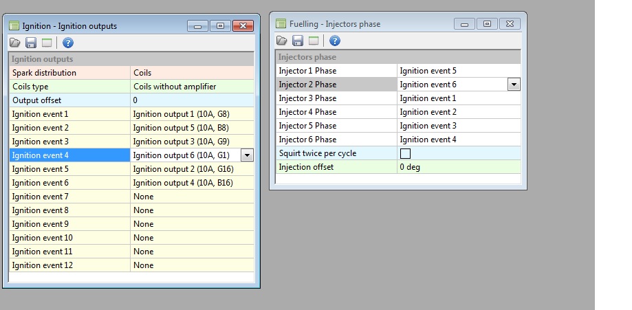

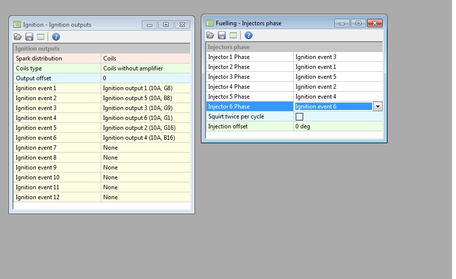

killerbee
Posts:67
Joined:Mon Aug 18, 2014 3:12 pm
Post by killerbee » Tue May 26, 2015 6:15 am
This was one of my firsr questions when get Emu , conection between firing order and injector events . What will be the bes for power ans idle for 6cyl bmw . Firing order is 6 4 2 1 5 3 so when ti fire injector 1 ? Now i fire it with coil 6
killerbee

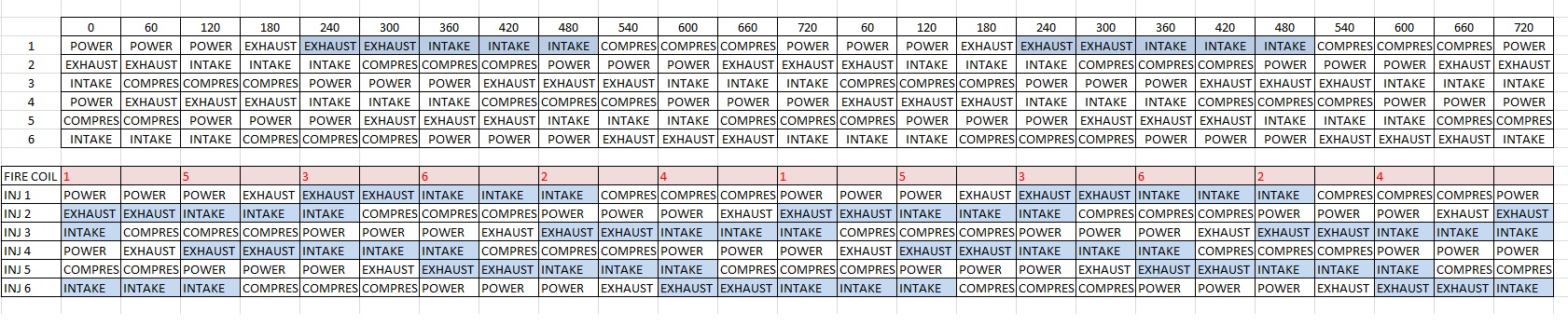

Posts:67
Post by killerbee » Wed May 27, 2015 10:23 am
Sorry for my writing , someone can have it as spam but I see major mistake in my car so after reading this post I assume that if firing order is 1 5 3 6 2 4 ( number of cylinder ) then injectors must squirt 2 events earlier or 2 4 1 5 3 6 ( number of inj )
or injector phase 1 must be when injector 1 start to squirt , then 2 events before its spark is firing cyl 2 but cyl 2 spark is ignition event 5 :) so inj phase 1 must be set to ignition event 5
And if I think right here is what must use ( attached pic )
But if we look at engine cycles it is better to start injector 1 with the spark of coil 3 and then injectors phases must
