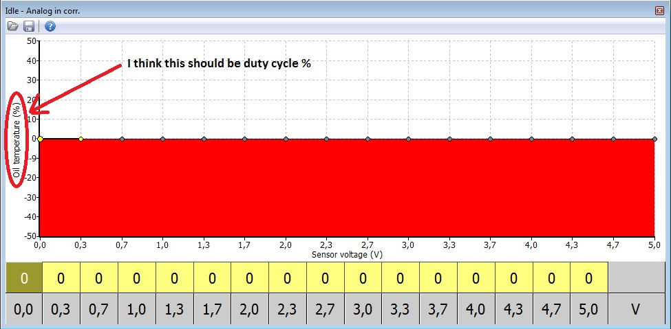

The option to change the color design of the tables does not work on 1.060. And i think the table labeling of the idle/analog correction table is wrong, see the following pricture.

Thanks. We reviewed all tables description.
The color problem is already fixed.
