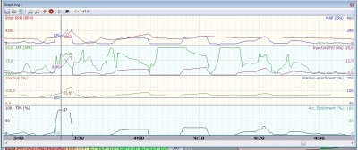

When you will be at 4000 RPM close the throttle to eg. 10%.
The vaccum appears.
The vaccum appears.

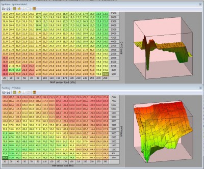

skogs wrote:I talked to the tuner today, and he explained what was going on with the table. It looks bad, but works great. There were some values that were put in simply as a failsafe in areas the car is never supposed to be in. For example vacuum at 6000rpm or high boost at 2000rpm. In the diagonal from vacuum at idle and to full boost at max rpm everything is as it is supposed to be.
We cleaned up the map a bit and took a few runs, no knock and good power. The throttle delay at idle was removed, but the slight starting issue is still there but its not a big problem.
You are kidding us right?
Im wasting my time, your on your own.

PSI-Motor in general if You are a "professional tuner" and You know how to sell your product, You can make ignition map flat with 10 degrees of advance. Engine will be running good, and map will be safe up to 250 kpaPSI-Motor wrote:skogs wrote:I talked to the tuner today, and he explained what was going on with the table. It looks bad, but works great. There were some values that were put in simply as a failsafe in areas the car is never supposed to be in. For example vacuum at 6000rpm or high boost at 2000rpm. In the diagonal from vacuum at idle and to full boost at max rpm everything is as it is supposed to be.
Skogs, yours ignition map, may be safe for Your engine (i'm not so sure because it looks like 5 minutes work without any thinking just to take Yours money) but for me and for others it's a garbage. I could make You better map without going out from home, without knocking, without wasting power.

The car would run of course, but it would be week och run hot on both CLT and EGT.

Hi!
I'm a developer of EMU and I can assure you that your tables do not look good.
Retarded ignition can destroy outlet valves and put thermal stress on turbocharger.
Here are 3sgte tables (you should see the difference between yours and ours). And remeber that there is much much more tables that need to be set up correctly to make the car drive nice and safe.

More aggressive ignition timing would result in engine knocking. Your map is against physics laws. Timing should rise with RPMs, in vacuum timing should be more advanced that it is. You have 2 examples, from PSI-Motor and from Jadzwin. Both are from different car, but both are similar. Your ignition map look totally different, made in opposite way.

This is what i am able to read from my current map, please correct me if im wrong.
Too retarded ignition at low load and high rpms causes unecessary heat in the exhaust.
Too advanced timing at low rpms and mid/high loads combined with lean mixture can cause knocking. However, how serious can knock be when the boost is low? By lean i mean literary off the scale.
Correct?
Correct?

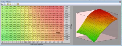

Useable VE table?
Made it using Kisielisodd's table as a guide, most as an excersize.
