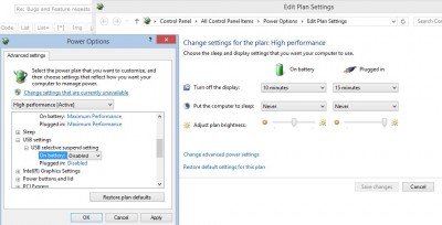

do you tried with other usb cable to connect EMU to laptop ? some time ago after more than year in the car i have similar connections issues but the real pain was error during software update ( i brick my EMU ), after Jadzwin fix my device and check that all is alright with the hardware i installed it into a car and again same issues... long story short try change usb cable
and check power options for battery in windows setup :
A USB device driver can send a message to windows telling it to idle the device. This puts the device in a low-power state (the suspend state). When a USB device is suspended, windows does not wait for it to respond before entering a sleep or hibernate mode. If you disable this feature, the system will simply return a failure to the driver when the driver attempts to enter suspend state. If the driver complies with Microsoft guidelines, it will simply retry the idle request at every expiration of its idle timer.

Thank you. It has been ok last few times but it makes sense, the cable end has been on the dirty and dusty floor of a race car for a long time while other work was being done, so very likely the connections were not clean
