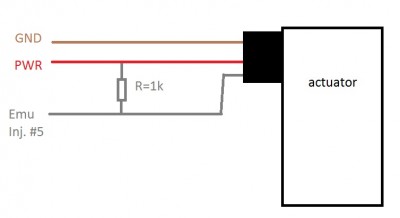

Hello Jakub, again a problem with my wastegate actuator, the wiring sheme is like in the picture attached. The signal should be a PWM signal @300 Hz with duty cycle between 3 and 93%.
I measured with the oscilloscope a very nice and clean square wave with a very exact frequency at the signal wire, but the duty cycle only shifts between 2 to ~75% even though I set the min/max values to 2/98% in emu client.
the strange thing is, Emu somehow makes a additive error to the dc.
E.g. 29% in emu client makes a real DC of 2% and 100% in client makes 75% in reallity. So when I further reduce the DC in client(from 29 % downwards) real DC stays at 2%. that happens vice-versa when inverted the output.
Is my wiring correct?
what could be causing that problem?
thanks in advance! :)

Post by Jadzwin » Mon May 11, 2015 3:09 pm
I will check it. Can you send me your configuration ?

Post by Jadzwin » Thu May 21, 2015 11:33 pm
Hi!
I've checked your settings and boost output. Everything works as expected. I suppose that you have problem with the DC Error correction table that change your DC.
