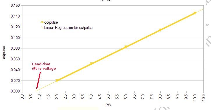

Anybody think about a injector calibration cycle ?
2000 pulses at 2, 4, 6, 8 and 10 msec. Measuring every time the cc output you can put on a graph on the X axis the PW and on the Y axis the output in cc/pulse .
So you have in one time also the real injector dead time.
As you can see here on graph from other website.
You see in example the five measuring points and the dead time at 0.8 msec.
Not 100% correct as the real injector curve is not linear but better than nothing.
