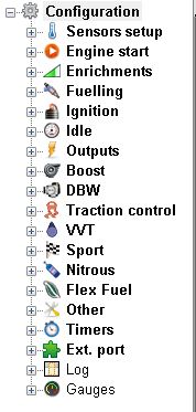

Post by Karel » Sat Aug 08, 2015 12:57 pm
I cant see knock sensor menu ..... why ?
new version
old version
Phil
Posts:6
Joined:Fri Aug 15, 2014 8:45 pm
Re: Bugs and Feature reqests
Post by Phil » Sat Aug 08, 2015 5:22 pm
Have you gone to the Tools menu, then Available Strategies and checked if knock sensor is selected?
Post by Karel » Sat Aug 08, 2015 11:53 pm
Phil wrote:Have you gone to the Tools menu, then Available Strategies and checked if knock sensor is selected?
Phil thank you ............ i was never in this Menu "Tools" and didnt switched anything OFF. The same with changed KEY "mapping" for add, sub etc....
It has changed between versions, not by my wish. So i would like to say "Unwanted changes".
Thank you for help
Post by Jadzwin » Sun Aug 09, 2015 11:55 am
This bug is already fixed for next version.
