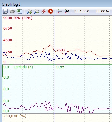

Please also corrct the view in log. If i select AFR its OK, but if selected lambda view it ends with line on top.........

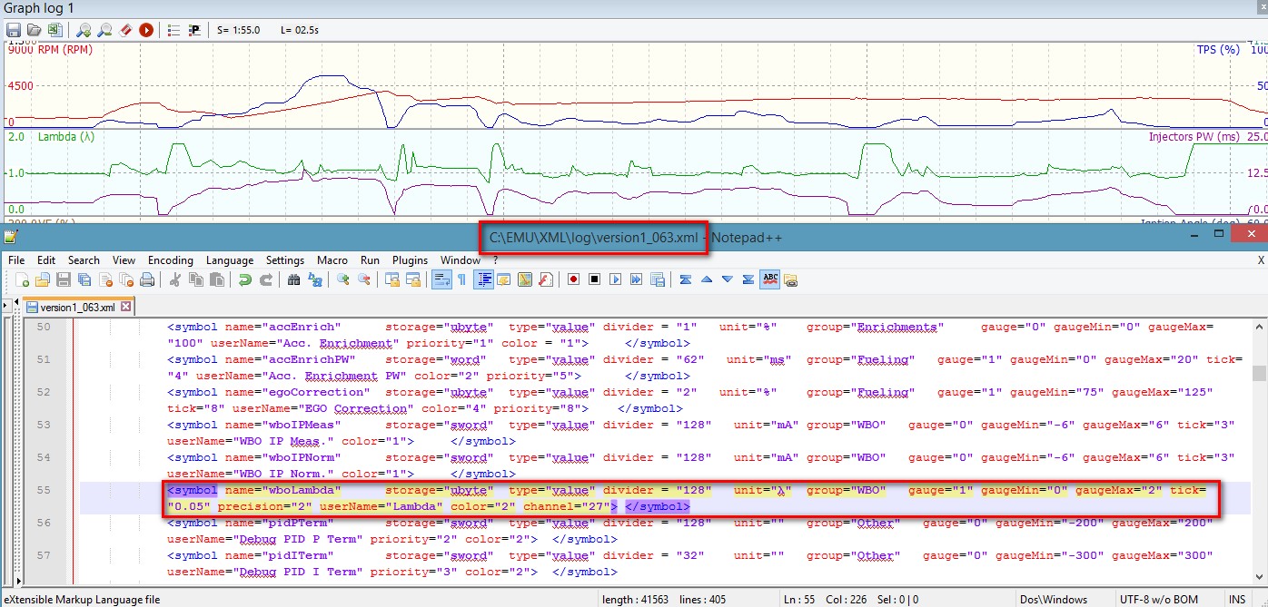

For now you can easy fix this issue by editing config file :
..\EMU\XML\log

Thanks!
