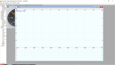

Hi.
Maybe you can bring support for High resolution displays
Mine is a 3200x1800 display with no chance to change it...most of programms can handle this, but not EMU Client.
I don't know wether it's a small change in you prog?
It looks this way :

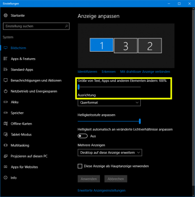

Your windows uses a zoom for texts, apps and other elements of > 100%.
Solution 1:
Set it to 100%. Unfortunately this is a very common problem for many applications.
Wild guess 2:
You are running the client on a MacOS with the hypervisor "Parallels" for emulating Windows.
Solution 2:
play around a bit with the parallels options for screen rezising and zoom. Chose the option that passes the genuine Mac resolution through to Windows.

Thanks for help. I use Windows 10. I have a set 250% zoom. But when I put it to 100% everything get smaller of course. Then I cannot even read the tablesCorvin wrote:Wild guess 1:derOJ wrote:Hi.

It is a matter of luxus I guess

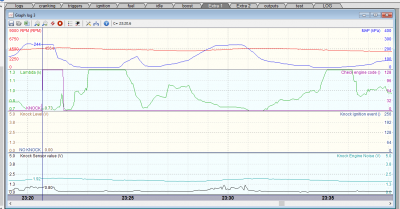

The check engine light for knock output is not accurate. it's been coming on even the knock sensor value is below the engine noise threshold.

Please think more about what you are writing. The datalog is written may be 25/s but the engine can spark 50-100 times per second. Also the "knock" (voltage over trigger) can happen many times on single working cycle of each cilinder. So it can easy happen, that your engine will knock, but the log will not show it.
Again, please do not make any fast judgements, if you are not sure about what you are talking.
Thank you.

It's too sensitive would be a better choice of word I suppose............

I think is talking about the fact that even at 1.92v engine noise is set and 0.80v of sensor value, the ecu triggers a Knock check error code even if knock level and knock ignition event remains 0, thats what i can see at is log image.Karel wrote:"Too sensitive" ??? Are you joking? So you would prefer knock detection system that is inacurate, slow, and deaf as a post ?forhome wrote:It's too sensitive would be a better choice of word I suppose............

I don't think he even saw the picture or get the point of my post.............

If you start talking like that ...... are you sure, your "Check engine" light comes up because knock ? Did you looked into the log for reason why the light was on ? There are other reasons for triggering the Check engine ...forhome wrote:I don't know why Karel keeps having his head up his ass with all his useless comments. I am just reporting a possible bug I have discovered. There's no need to be hostile.....................
EDIT: Post an log file, calibration file and i will look into it...
