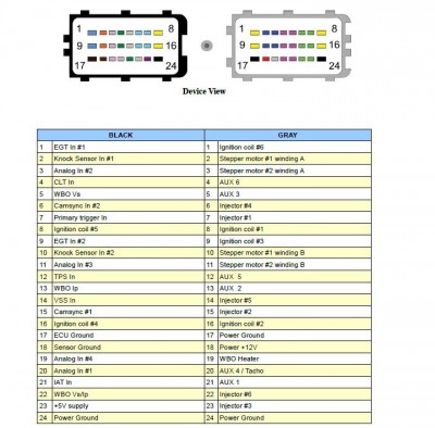

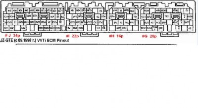

Hi everyone,
I need help with wiring up the EMU to 1jz VVT-i. any help would be appreciated.

WHPZach
Posts:184
Joined:Tue Oct 07, 2014 11:13 pm
Re: 1jzgte VVT-i ecu to EMU wiring
Post by WHPZach » Fri Apr 15, 2016 5:53 pm
Be aware that there were two versions of the VVTi 1JZ, so be sure to doublecheck everything.
Here's a link to a VVTi 1JZ pinout for the EMU: https://drive.google.com/open?id=0Bz3_t ... WRSQVFEMjA
Jostar
Posts:59
Joined:Sun May 24, 2015 7:42 pm
Post by Jostar » Fri Apr 15, 2016 6:08 pm
Thank you Zach!!!
This is the reference I was looking for.
I totally agree with the different 1jz VVT-i pinouts.
The pics attachments I uploaded is what I have.
