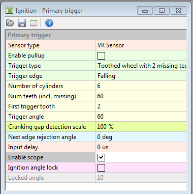

hi i have audi 2,7 /singke turbo on emu
i remap primary trigger like this http://images.tinypic.pl/i/00747/1x49ocnrvl1b.jpg
i have spark but ignition is missfire. all is gone on intake manifold.
i put first piston in GMP and paint a dash on crankschaft pulley. I checked the strobe lamp but is thre difrend place
Re: Audi 2.7 Turbo Trigger problem
Post by PSI-Motor » Fri Jan 22, 2016 1:31 pm
Number of teeth including missing should be 60 not 58

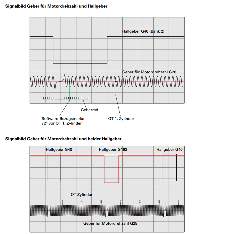

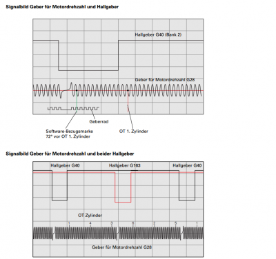

Your configuration is wrong see picture of RS4 Trigger system below and the right config.
But only with prim trigger you have to use wasted spark. I would prefer sequential ignition and injection and the RS4 engine has the sensors that you need at both inlet cams! Then you have to configure your secondary trigger system.
And please make an scope of your trigger.
