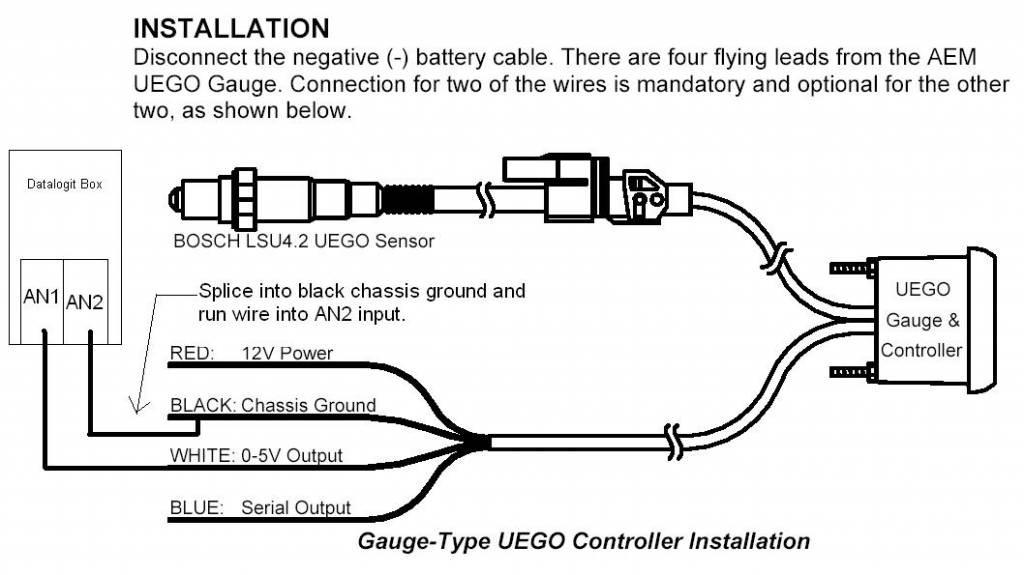

Thanks for the quick reply but im pretty new in this and im not completely following. What wire do i need to use as input for the EMU?
Re: Bosch lsu 4.2 or 4.9
The picture shows 4.2 sensor... Anyway in aem 30-4100 (lsu 4.2) and 30-4110 (lsu 4.9) the white wire is analog output and you have to connect it to an analog in 1-4 on EMU.
