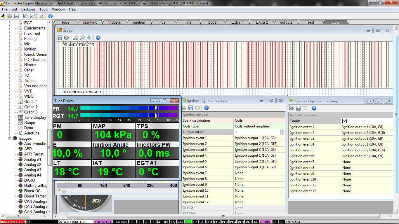

Hi, need some help, i need to see if i ve got the ignition Outputs right, car is Opel with X30XE Engine with Turbo, I will upload the ignition and injection settings to see if I have something wrong. On autodata tell me , the ignition firing order is 123456 and I am using a original wasted spark coil witch is a double fire coil 3x 0221503002, car wants to start but sometimes i can detect some missfires. Ive also check the ignition angle and is correct.
Coil Wiring:
Ignition 1- Cylinder 1 and 4
Ignition 2- Cylinder 2 and 5
Ignition 3- Cylinder 3 and 6
injection
ignition

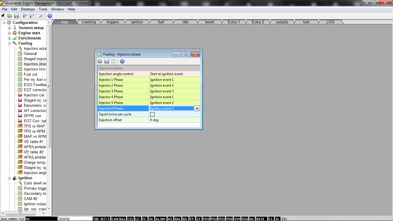

I forgot this one

Seems alright if you have them wired Coil1 to Output1, Coil2 to Output2, Coil3 to Output3.

Post by pric » Thu Mar 02, 2017 1:19 pm
But you are going for bank fire?
Because of no CAM sensor and your injector phase...
Enable "squirt twice per cycle"
Are you getting spark and fuel?
If so, try adding/removing pulse width in the cranking fuel table.
Could be missfiring, because of too little fuel.

Post by pric » Fri Mar 03, 2017 7:00 pm
NO you don't have to wire them differently.
But without cam sensor you can't run sequential injection.
Therefore you have to use squirt twice per cycle,
without that the injector is firing on the wrong stroke for one cylinder,
which is referenced to the same ignition event.
Other than that looking at the map you are drowning the engine.
Cranking fuel is way too high, and you have batch fire and prime pulse activated.
Deactivate prime pulse and lower the cranking fuel table to 2-5ms.
If you have the possibility of using a cam sensor, use it!
greetings

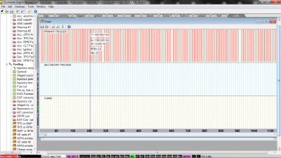

Hi pric, thanks for your help, the problem has been found, i have the pull up option activated in primary triguer thats why it didn´t want to start. after deactivate that option car started firts time.
Many thanks
