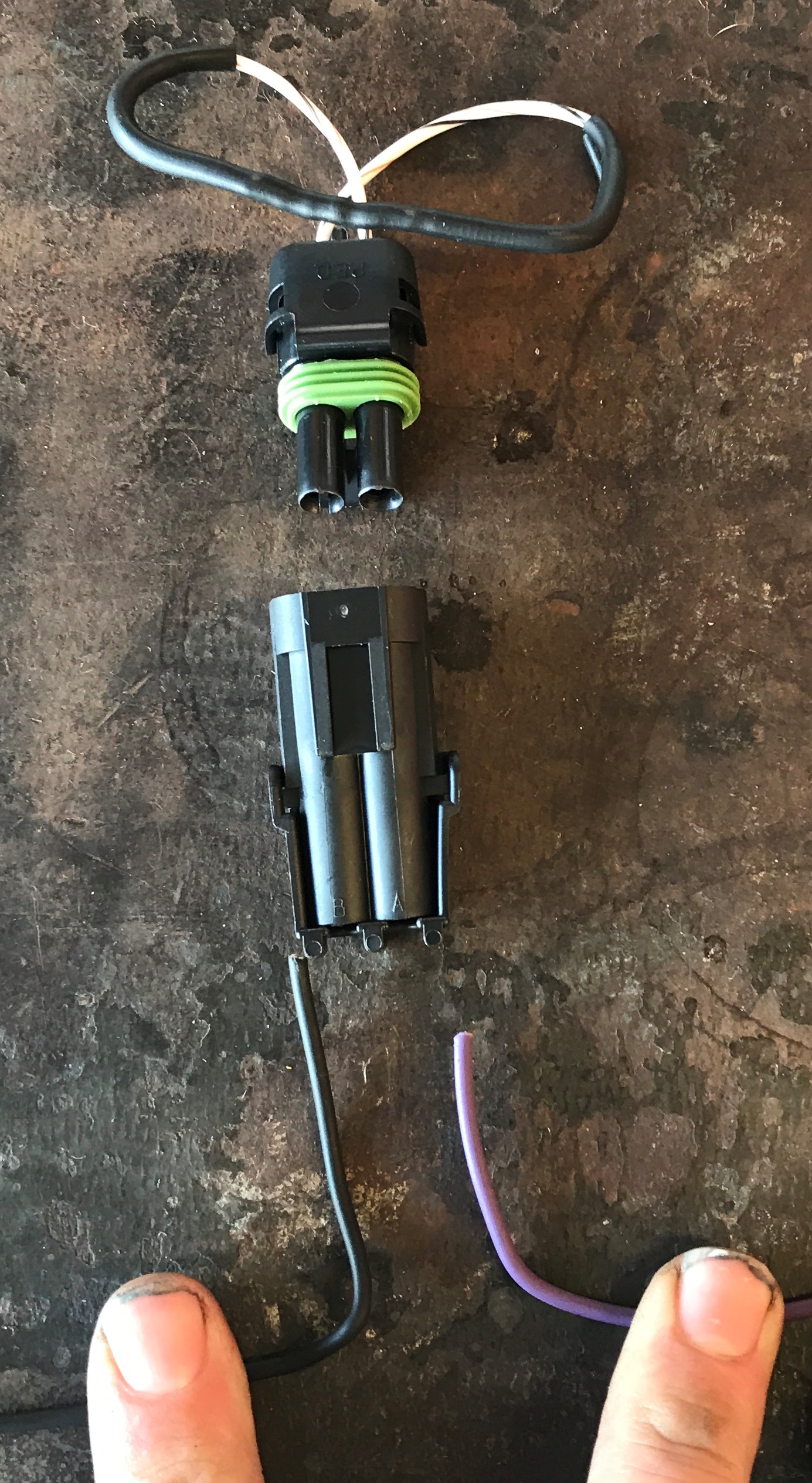

I came up with this idea to easily try various resistors. Using a 2pin weatherpack, with
various jumper resistors.
The solution to my issues was a combination of both primary and secondary. I added a 20K to primary and a 10K to secondary and issues are gone.....Still unknown why signals were perfectly fine with W58 trans for over a year, but with AR5 this issue came up...
