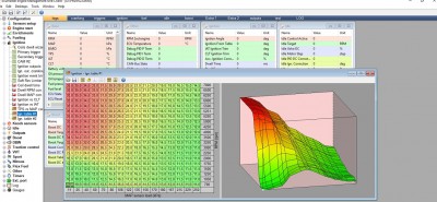

Hi is there anybody that can have a look at my ignition map and what they think
about it ?it is a subaru ej22 with reworked chambers in head some porting ,compression ratio is 8.5 runs on 98 ron gas
wrx injectors TDO5L turbo and for moment only 10 psi of boost!
ignition map advise !

I dont know about EJ motors but the ignition map looks very conservative and needs more to it, the map looks like the base one that came with it and added maybe 2-3 advanced?
I would remove some columns and re-scale as per my target boost, you have until 22psi in the X Axis.
