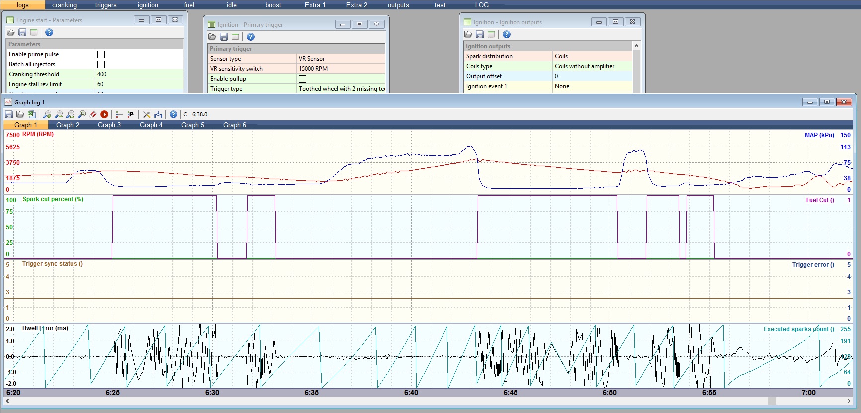

what causes Dewll Errors??
customer is getting some big errors but only on over run fuel cut??
car has active igniter LS1 coils wired in pairs to run wast spark

Re: DWELL error
Post by Karel » Tue Jul 04, 2017 11:32 am
errors in trigger
Re: DWELL error
Post by RHD » Thu Jul 06, 2017 4:00 am
yes ok so what type of error?
its only happening during over run fuel cut and there are never any trigger errors shown directly
Re: DWELL error
Post by Karel » Thu Jul 06, 2017 11:40 am
RHD wrote:yes ok so what type of error?
If you do overrung fuel cut, are you also cutting the ign ?
Re: DWELL error
Post by RHD » Sat Jul 08, 2017 1:18 pm
its actually a customers car... i just looked at his map and yes spark is disabled during fuel cut...
so in that case the error could just an erroneous glitch in the software when the spark is cut so it can be ignored?
