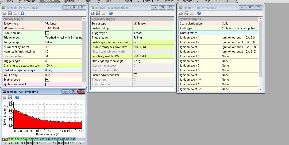

i run a st215 ign setup , same as a beams iirc
pic attached , the dwell times are for my aem smart coils so you best double check for your coils .
