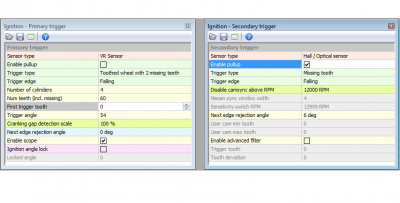

Some fellow student und I have some problems with a project on a 1.6l EA111 Volkswagen engine.
The programm shows us, that the ignition status is not synchronized. When we start cranking motor, there is no singnal on the oszillograph (rpm=0). We need help or some wizard material for the EA111 1.6l (77kw). Espacially for the trigger setup, we dont know if the setting we've selected are right.
The Primary Trigger (VR Sensor) is connected to ECU at pin B7, the seonsor is also connected to +5V and SensorGround.
Best regards!

VR sensor dont need +5V. Are you sure that u are using vr sensor ? Or it is hall sensor ?
