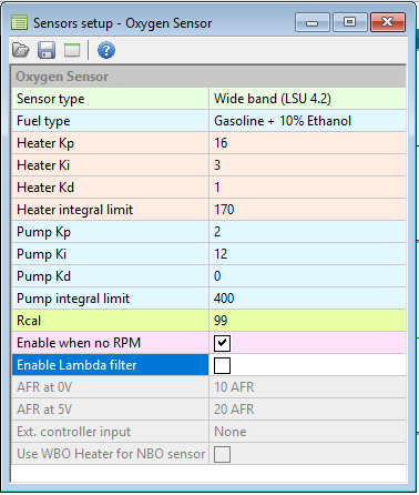

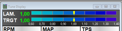

I got no WBO Lambda Signal. I have testet the cables, the seonsor. All ok. The channels of the WBO looks also ok. But I got not Signal in the Monitor/Software.
Do anyone have an idea what could be the problem?

I testet now the cabels again. All OK. With my Innovate LM2 the sensor works also. I testet also a another EMU on the cables. Same situation.
Can it be an problem of the BaseMap? I did used one of this forum, while load it first time, errors comes. Can it be a reason?

First of all, why do you use the setting "gasoline + 10%"
