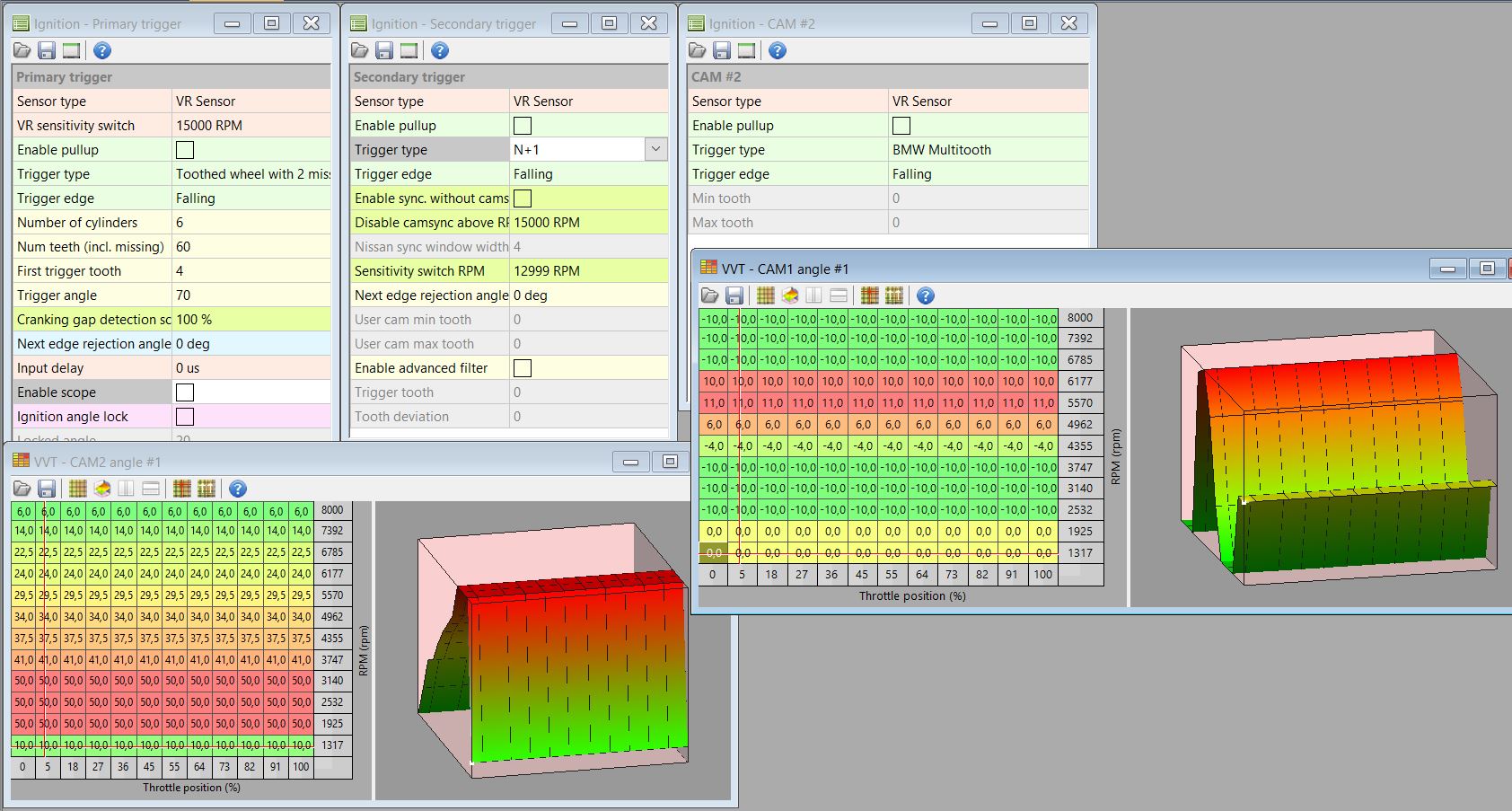

Hi
Have problems with secondary trigger signal on S50B32 engine.
All three trigger sensors are VR type. 60-2 cranck wheel, 6+1 exhaust and 6 intake wheel.
Can someone please check trigger settings, vanos settings and maps.
sec trig set falling.emuscp
(465Bytes)Downloaded 65 times
22.04.emu
(78.14KiB)Downloaded 77 times

Re: S50B32 problems with cam sync and more
Post by Karel » Mon Apr 23, 2018 9:32 pm
well, it looks like everytime ... shitty old wirring, and noisy mag signal from cams...... try to use some pulldown resistors ...... or make proper wirring harness and it will worl fine.
Post by Karel » Mon Apr 23, 2018 11:45 pm
cca 1k Ohm will be my start something between 500 Ohm and 2k Ohm worked in most cases by me.
