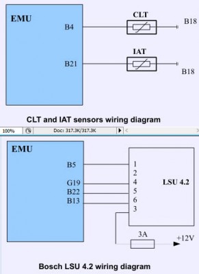

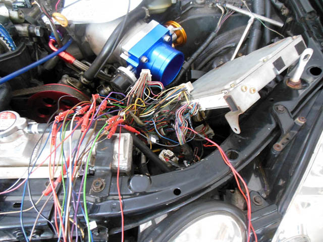

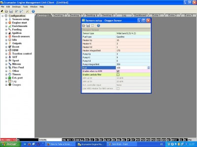

Re: Need Help
Tuner said he confirms all wires are correct.
Let say CLT sensor is broken.
It works properly if using stock ECU and Greddy EMU piggyback.
I bought brand new LSU4.2 Lambda sensor with connector kit from UK ECUMASTER.
I dont think sensor broken or wire problem.
I enclose pictures.
I am not mechanic or tuner but to see how it is wired I am sure "the right pins in the plugs".
Each wire is labeled for easy checking.
I enclose pictures.

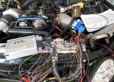

ECUMASTER (dont have to say name) told me to remove stock ECU to solve problem.
At first they said to use stock ECU for ABS, 4 wheel steering and other features.
I prefer not to use ECUMASTER if ABS, 4WS not working.
It is messy when it was being wired.
Now it is quite clean engine bay.
ECUMASTER installed inside dashboard.
I enclose picture with ECUMASTER installed (no messy wires).

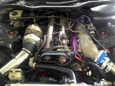

"i assure you EMU are far better and easier"
I bought it for much better price comparing to HKS and LINK installed in my other cars.

Re: Need Help
lets start with the WB problem, put these settings on you file, for Rcal use the value measured with ohmmeter on your sensor.
As for the CLT problem, did you wire the sensor directly to emu or is it shared with oem ecu?

Re: Need Help
"As for the CLT problem, did you wire the sensor directly to emu or is it shared with oem ecu?"
Directly to EMU and according to manual.
Sensor wires are cut then connected to EMU.
No CLT wires connected to OEM ECU.
I will take picture tomorrow to show you.
