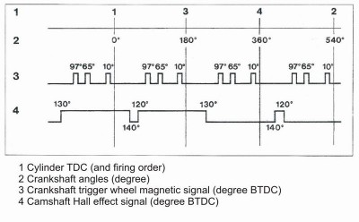

Im new in the EMU world.
tryring to get a fiat 1.8 16v to run..
just wire it in.
setting up the ecu now.
can some one please look at the trigger settings i shoul use?
cheers

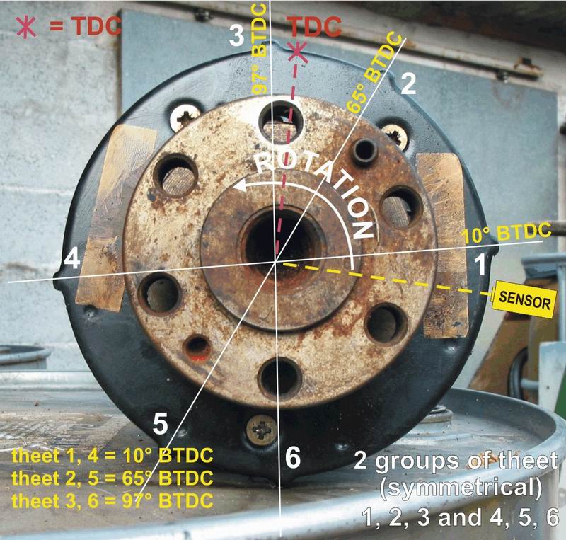

the rotation is the wrong way on in the pic!...
signal.
cam trigger
crank trigger

I was thinking...
2e tooth..
65 degrees.

Post by ESRA Car performance » Sun Feb 28, 2016 7:12 am
It's the same as a Subaru 6 tooth.
And that one is supported by the emu :)
Just need to know what to put in as the trigger

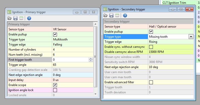

Re: trigger request fiat 1.8..
Post by Jadzwin » Tue Mar 01, 2016 1:34 am
Is it Fiat Stilo ?
It looks the same as subaru.
So I would give a try the following settings:
Post by Jadzwin » Sat Mar 05, 2016 8:29 pm
Please try my settings. Should work. Of course check the spark with the timing lamp.

Btw..
The rotation is the picture is the good way
Post by Jadzwin » Sat Mar 19, 2016 3:31 pm
The scope looks ok. This signal is converted to 2 tooth per revolution.
It works with cam sync. I sent you configuration.
You have to use cam sync otherwise it will not work.
