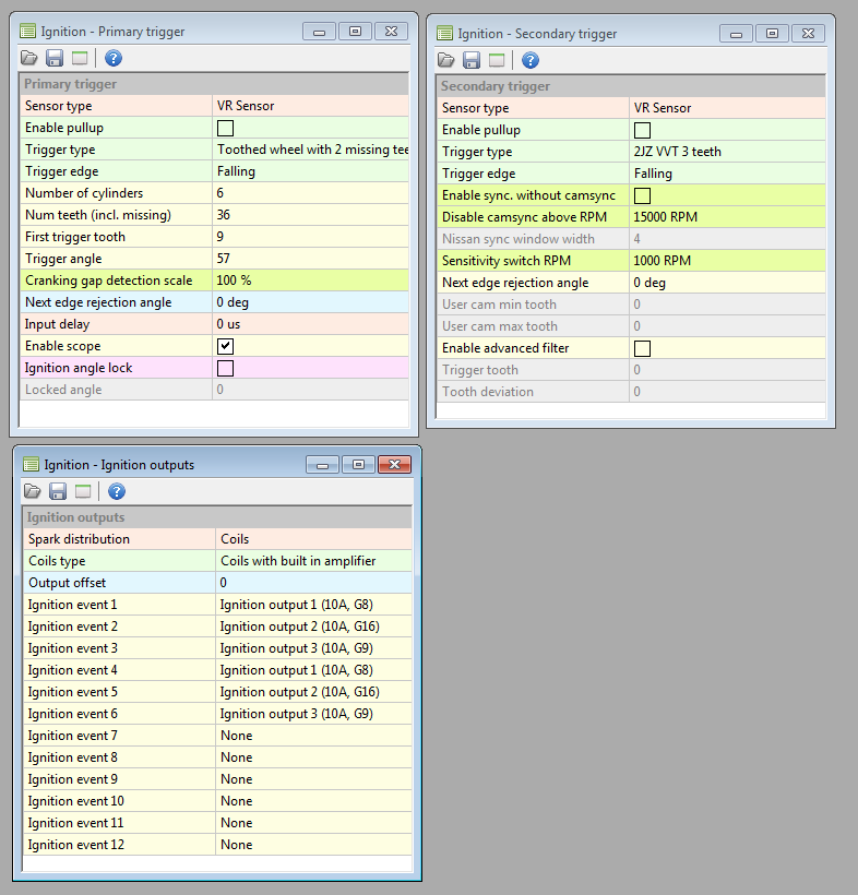

Hey Guys Im having a problem getting my Cam/Trigger to sync. I have checked wiring, both wires are shielded and grounded at one end.
Trigger:
VR Sensor
Toothed wheel 2 missing teeth
Edge- Falling
CYL-6
Teeth-36
T angle-63
Secondary Trigger:
VR Sensor
2jz vvt 3 Teeth
Edge Falling
I have scoped the Signal wires and verified I am getting a signal but it does not Sync?
Hopefully someone can help I am out of ideas

First check your Configured Outputs !!!
Aux 2 is enabled for Fuel Pump an Boost Solenoid this will not work .
Then Ignition Event Output 2 4 1 5 3 6
Injector Phase 3 1 5 2 4 6
Lets make a Test
Lets make a Test

the configurable outputs are not connected to anything yet.....
and 1-5-3-6-2-4 ? for the ignition events

Re: Ignition Sync Probllem 2JZ GTE VVTI
How did you wire up your crank sensor? Did you use the original harness and cut it up, or did you run new wires?
My customer used his OE harness that he cut up. He went all the way to end of the harness, where the shielding ended, and he did not even ground the shielding.
His car syncs pretty quickly. It's definitely not 3-5 seconds, more like two.
What firmware are you running? Can you post a screenshot of the scope log? What RPM do you see while cranking? What's battery voltage resting at with the key on and during cranking?2JZSLOWSTICE wrote:Well I think im ok with the flooding problem, dialed the tables way back and its starting now rough I have to fight with it but it starts ... but it still takes forever to sync like 3-5 seconds of cranking if im lucky.... sometimes it never syncs... ......new question why does it take forever to sync?
is that a sign of improper wiring???
Noise??
Bad connections?
I think if I can get this sync problem fixed ill be ok enough to get it to the tuner
Zach,
Frimware is the 1.1Rc1
I will upload the scope data
It seems to sync when it wants .....some times it syncs right away, sometimes it never syncs and cranks and cranks and cranks
The Vr sensors are good the engine started and ran fine on the OEM ecu
Battery Voltage is 12.3-12.9
When Cranking I see 160-170+ RPM and after start I see good RPM
