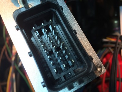

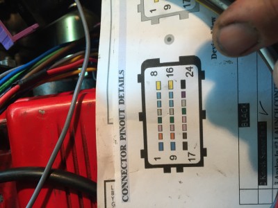

I'm assembling ECU on my Swift GTI, and i'm doing the wiring now. But I have a small/huge doubt.
On the manual the pinout shows it's ascending from left to right, so the pin one is on the left and the 8 on the right. But today, I was seeing more carefully to the ECU and seemed to me that I saw some numbers over the pins, but those numbers were ascending from right to the left, and this made me start to wondering if the pin out on the manual it's wrong or the number on the ECU are wrong...
From which should I consider?
Hope anyone can help me.
Thx in advance
- manualpinout
- frontview

by roquete » Fri Feb 26, 2016 2:21 am
Pins on manual are correct, looking at the ecu.
The numbers on the plugs are oem for those kind of plug, dont pay attention to them.

by DaRK » Fri Feb 26, 2016 2:44 am
roquete wrote:Pins on manual are correct, looking at the ecu.
Thx mate. Will do as you say.
once more thx.
