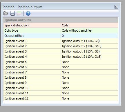

Hi , is this correct for wasted spark ? 1 coil for cyl 1 and 4 on output1:G8 and the other coil for cyl 2 and 3 on output 2:G16 ?

It's correct.
