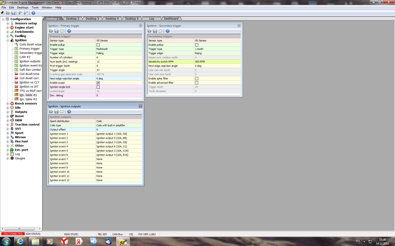

I have no doubt, 1jz 2jz are the most popular engines working with emu in all configurations.
My set up for triggers and ignition outputs:
Cam shaft sensor #1 (the one in the middle of head)
firing order 1-5-3-6-2-4
lom51

my settings 2jz
use Cam sensor #2

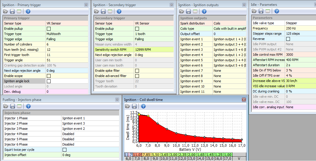

Kurt wrote:Indeed, polarity matters. If pinned as it came from the factory, falling edge is the correct setting for both cam and crank. You can check this with an oscilloscope. You can also get the EMU scope data at idle, mid, and high rpm and see how much the cam trigger moves between the crank teeth. If it stays towards the middle and does not get close to the crank tooth, then you will be fine. Checking timing with a strobe light won't show any issue with drifting of the cam signal until it crosses past a crank tooth and shifts timing (30° with the 12 tooth crank wheel).
I can agree to this. Falling edge on both is the correct one for me. When i used Rising edge on the cam sensor the ignition was flipping between different revs. Low revs had one base ignition and high revs had Another even though i had it locked on the same degrees. It was about 30-40 degrees difference.
So, i got the Engine running. With a fully loaded battery the car started and with some tuning the car idled smooth at 950 revs.
I have attached my settings.
Can anyone verify my idle settings?
Cheers,
Joakim
