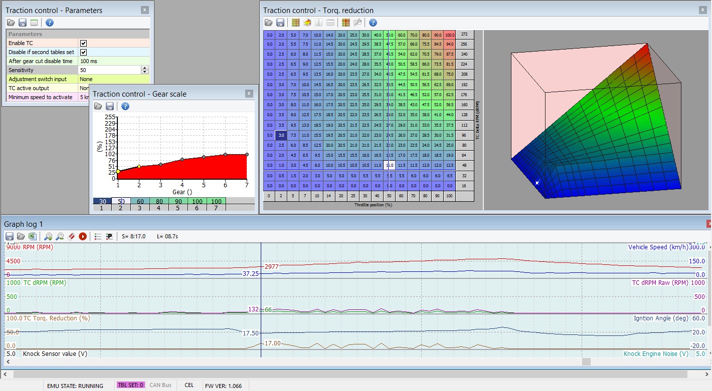

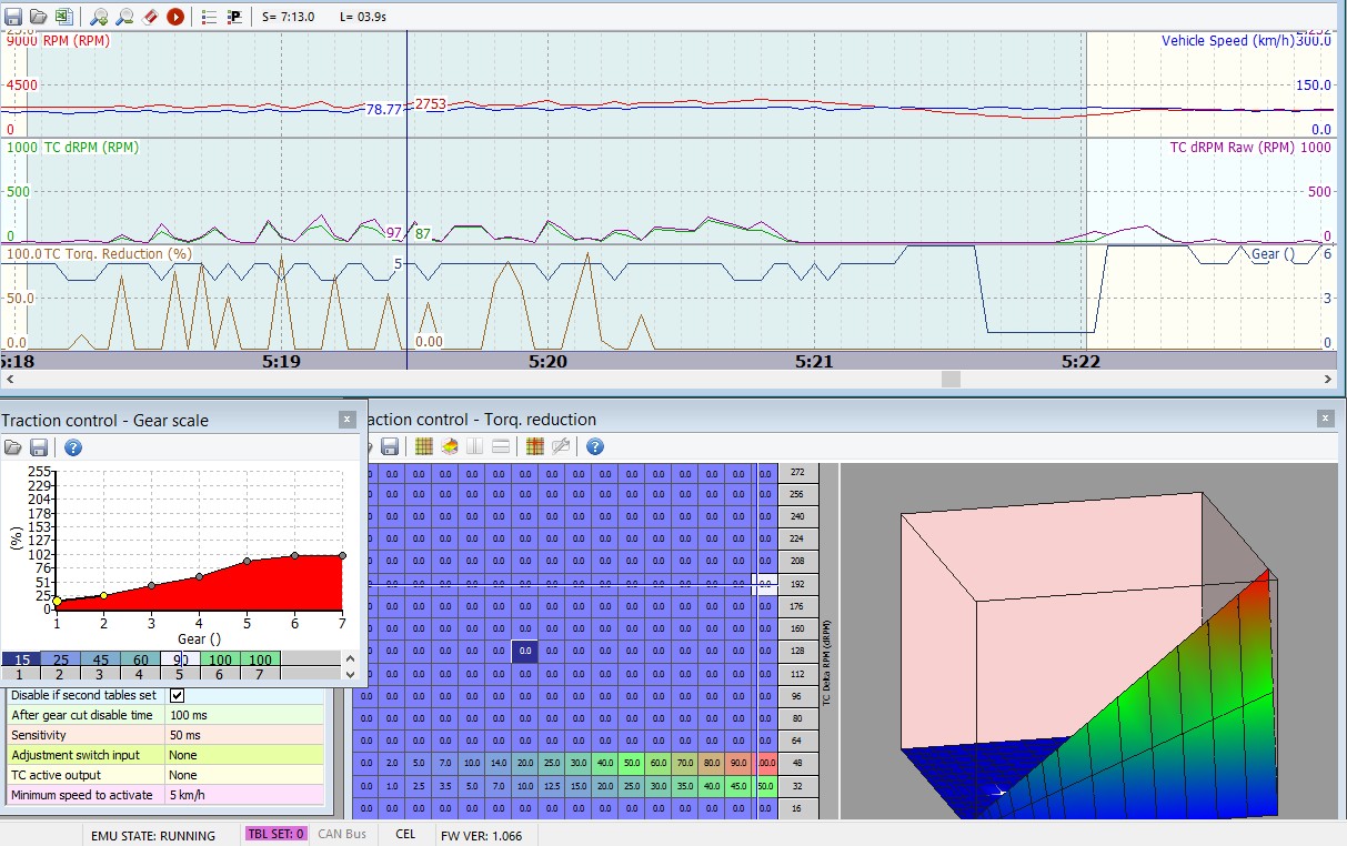

Wuniek
Posts:115
Location:Warsaw
Re: [TC] - Traction Control setup
Post by Wuniek » Wed Nov 19, 2014 1:28 pm
Thx for answer!
gregpe wrote:HI
First you need to determine what is dRPM when you have no slip per gear.
For beginning i want to set it up for first 3 gears and looking at the logs values are:
1 gear dRPM is bellow 20 (16-20)
2 gear dRPM is bellow 8 (5-8)
And when i have wheel slip on second gear dRPM is 20-40, i think something is completely wrong with this numbers because i move only at 2 first rows of Torq reduction table. Any ideas what to change to have bigger dPTS numbers? I think my gear scale should be inverted because now I’m hitting high values on 5 and 6 gear.
second gear
fifth gear
20141119_0944.doc
emulog
(406.01KiB)Downloaded 107 times
Post by Jadzwin » Wed Nov 19, 2014 3:19 pm
Your gear scale is too small.
You can also change sensitivity paramteter. The more the bigger dRPM is.

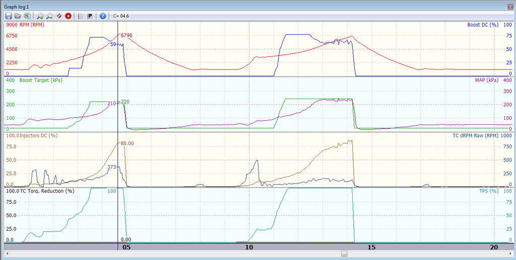

Can someone suggest a strategy for choosing TC Sensitivity value? With 100ms, I'm reaching TC dRPM Raw of about 370 in 1st gear with no slip. It looks like full scale for this channel is 1000.
I'm starting out with 100ms Sensitivity and trying to set the gear scale so TC dRPM is around 100-120 for each of the lower gears. It seems sensible to tune this so fastest acceleration reaches near mid-scale on TC dRPM Raw for 1st gear and scale that for each gear to reach mid-scale in the Torque Reduction table (~130).
Can anyone offer their experience so far with setting this up?

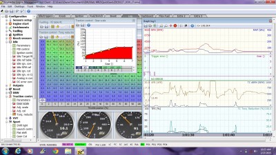

It is snowing here, and I couldn't make it to work, so I thought I'd do a little TC testing. For some reason my TC dRPM is really jagged, as in not very smooth. adjusting the Gear scale helped, but as you can see in the image, Drpm will go from double digits to 175 in 0.2 sec. I don't see this in the other logs above... What should I adjust? or do I have an issue elsewhere?
gregpe
Posts:204
Location:Cambridge, UK
Post by gregpe » Fri Feb 27, 2015 7:39 pm
hi
change sensitivity value
