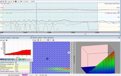

It is snowing here, and I couldn't make it to work, so I thought I'd do a little TC testing. For some reason my TC dRPM is really jagged, as in not very smooth. adjusting the Gear scale helped, but as you can see in the image, Drpm will go from double digits to 175 in 0.2 sec. I don't see this in the other logs above... What should I adjust? or do I have an issue elsewhere?

Posted: Fri Feb 27, 2015 7:39 pm
by gregpe
hi
change sensitivity value
