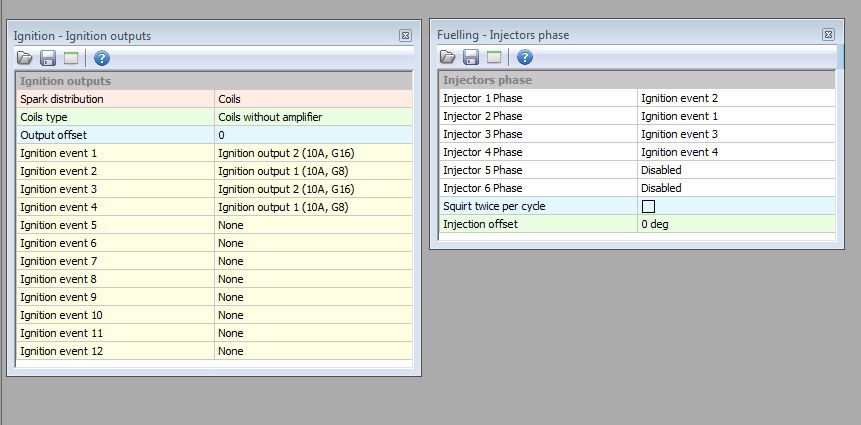

Hi
I have been going over the settings for the bike and i think i have made an error with the injector phasing for injectors 2 and 3 also i dont know where the offset of 60 degrees came from is this required? The engine is a 1999 Suzuki Hayabusa Turbo, the bike has been running well and making good power through the year
could someone advise on this please.
Thanks in advance

Is your firing order 1-2-4-3 ?
In general event if your injectors phase is random the engine will make good power and will work very good on medium and high loads because injectors opening time is relative long in comparision to crank rotation (DC).
Hovewer good phase can improve idle, and make the fuel economy better (on low / medium loads).

Hi
Yes firing order is 1243 from this i thought i had set injection to 4321 sequence, the engine is only realy used at high rpm and loads but the ability to idle is nice :) i have found the information below from suzuki
thanks for your help

so with a 1-2-4-3 firing order should my injector sequence be 4-3-1-2 or should i go with the suzuki chart which also gives 4-3-1-2 with an offset ? i assume the offset is due to high rpm (11000 max )
Final question is offset figure in EMU before or after ignition event ?
thanks for you assistance

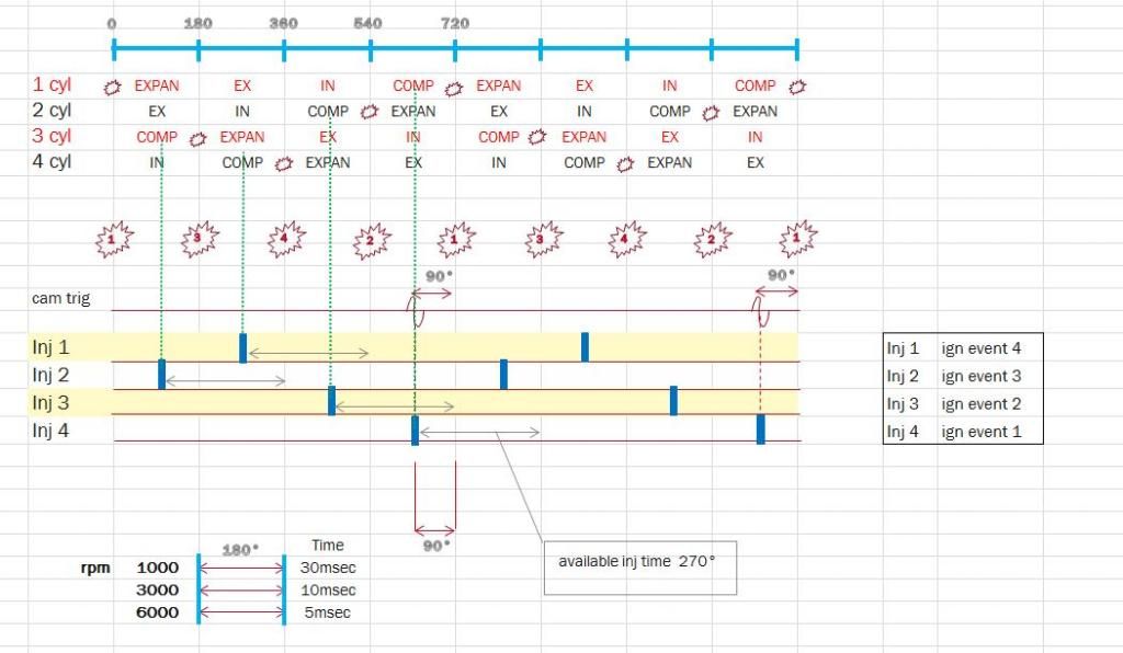

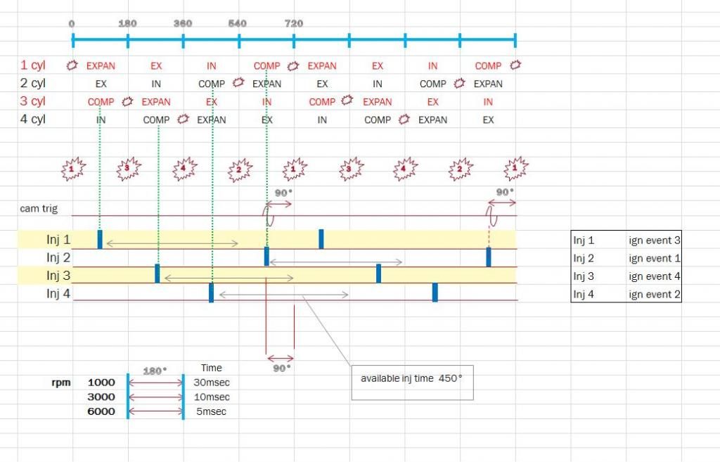

This i made for a 4cyl car engine.1342 ignition.
I hope i did cam trigger correct.
Now is the ouestion , which injection phase would be better? . Red, blue or green ?
Grts
Patrick

Patrick i think blue sequence is correct maybe lol

Post by PBU » Tue Nov 25, 2014 12:03 am
Mmm i doubt. I think it's to late.
Better would be variable injector phasing.
Start injection close to opening inlet valve on idle/low revs and pulling back on rising revs.
On very high revs it dosn't matter because there is not much time anyhow.
Any opinions ?

can anyone tell me if the offset in the software before or after the trigger event.
Wuniek
Posts:115
Location:Warsaw
Re: Injector sequence
Post by Wuniek » Thu Nov 27, 2014 9:53 am
in one of latest software you have working english help for it:
Fueling - Injectors phase
chris72 wrote:Hi Gregpe

Post by PBU » Thu Nov 27, 2014 4:09 pm
I do not understand what has wasted spark option to do with the injection sequence :?:
You still use ignition seq 1,2,3, and 4 .
Maciekx
Posts:22
Joined:Mon Sep 08, 2014 5:59 pm
Post by Maciekx » Thu Nov 27, 2014 6:51 pm
Injection timing is defined by ignition event, so there is a scheme how it works in wasted spark mode :)

Post by gregpe » Thu Nov 27, 2014 8:25 pm
ignition EVENT not ignition OUTPUTS so event is 1234 and outputs 1212 and injector is timed with ignition event !!
