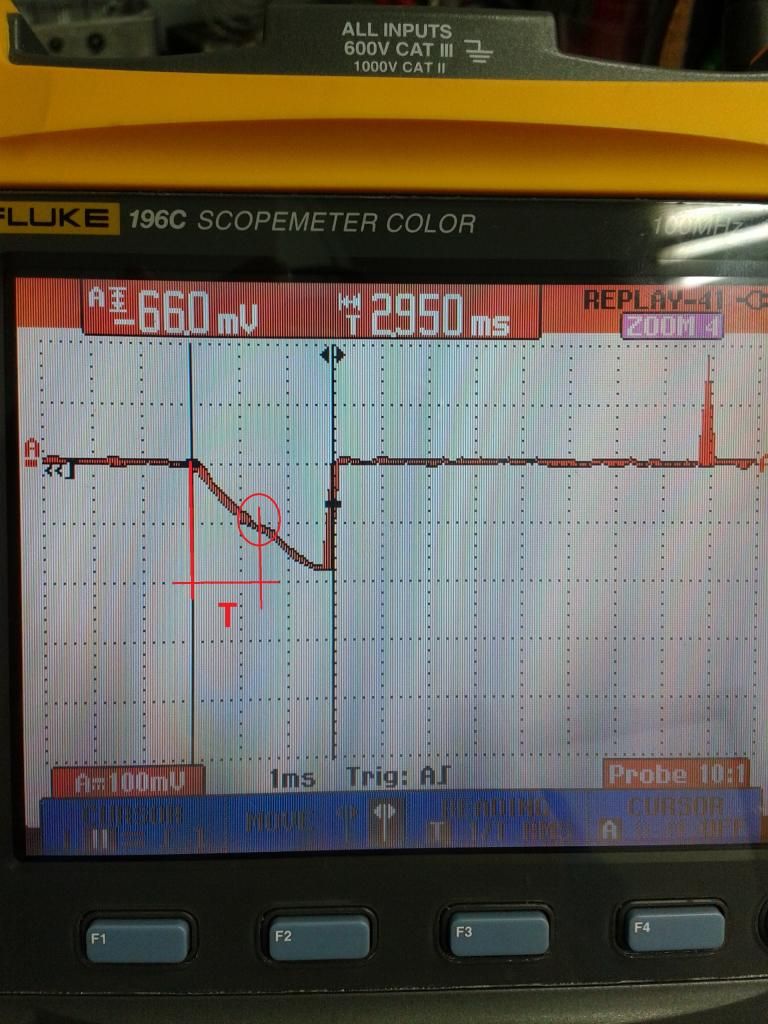

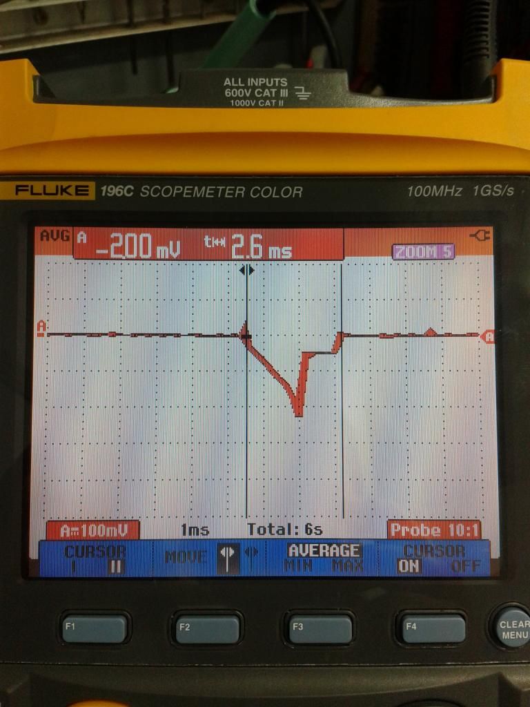

This is the original marelli injector current when driving the weber 025 injectors.They are low impedance.So i use a 4.7ohm resisitor on the ecumaster injector output.
You can see the opening and hold current. ( 100mV = 1A )

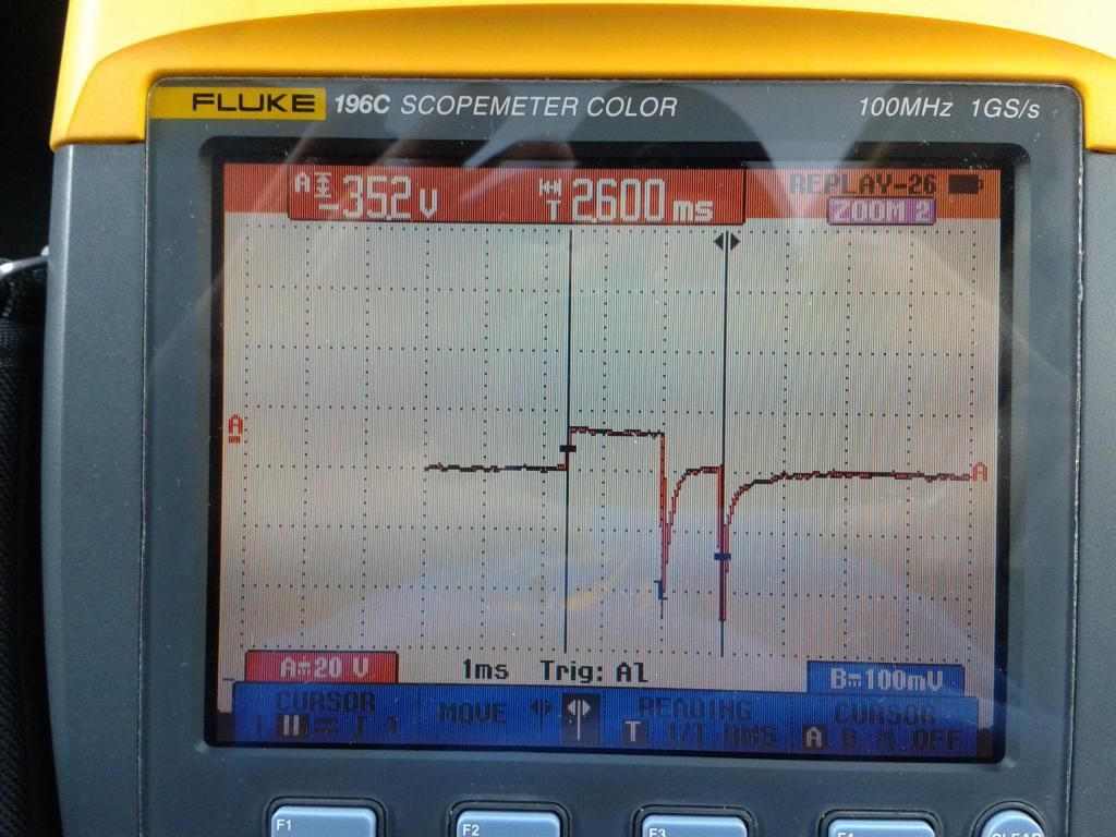

This is tension with the marelli ecu.

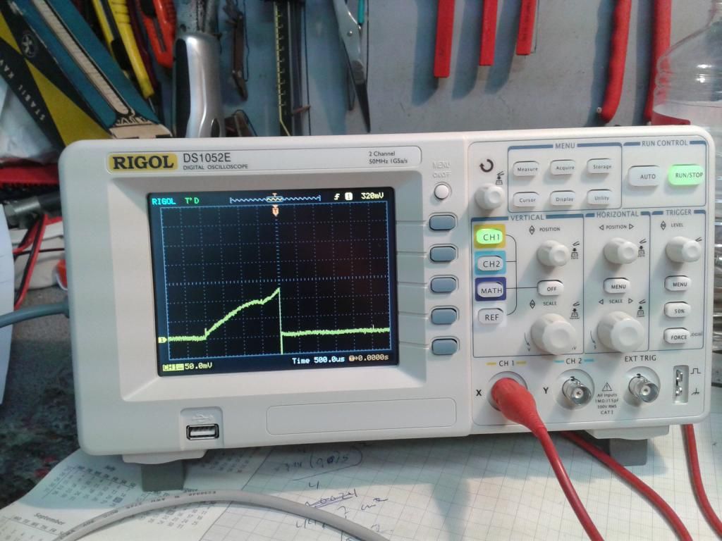

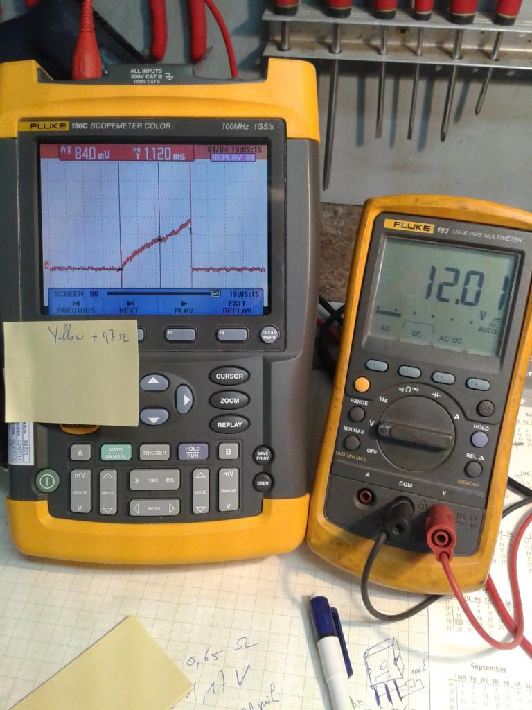

On the ecumaster current is different. Didn't measure tension.
There is no opening and hold current and the max current is also lower. 1.8Amp in stead of 2.2Amp.
Can i select open and hold driving on the ecumaster or is this not an issue ?
Is the injector driving fast enough to get good control.
