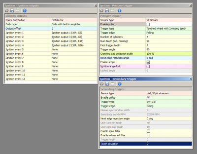

Today i checked the ignition with the timing light and the ignition angle was exactly on TDC. But i use following config.
And the Motor does not running. When i put the sec trigger of the motor runns. Maybe the Coils 1_4 and 2_3 are interchanged.
I will test your config tomorrow, thanks for that. But why i have to use "Distributor" and output offset 2 ?
Re: Problem with the second trigger at a 1,8T AGU
A few minutes ago i tried your configuration and the engine runs perfect
Now i can fill the VE Table and all the rest of the configuration.
Just for understanding, why i have to use "Distributor" and output offset 2? Yust to know

Spark distribution means the way how the dwell is calculated. If you use distributor the dwell time must be calculated betwen each cylinder spark so the time for spark is reduced. For coils type spark distribution the time for dwell is much much longer.
There should be coils for your engine
However it will work with distributor until your dwell will be in 180 degrees limit.
Output offset is used to change cylinder phase.
If output offset is 0 ignition event 1 assigned coil will produce spark first.
If output offset is 0 ignition event 2 assigned coil will produce spark first.
Output offset 2 is used to change engine phase. With offset 0 the spark will be in incorrect engine phase.
So it is better to cange it to "Coils" right?
Next job at the weekend will be to tun the stepper output on the AGU throttle. But i think it runs with high frequency.
Ill give you a feedback how is it going. Thanks for support.
Use coils.
And for idle motor please use injector or aux output with addtional flyback diode.

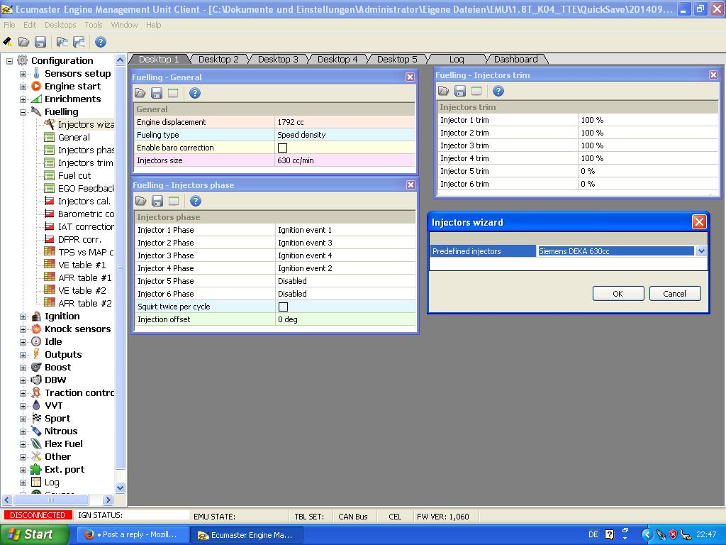

Re: Questions about the VE values at a AGU 1,8T
i hope you all had a nice weekend. But it is every weekend the same it is to short!
I have a questien about the VE Table, bacause i have values aut idle about 70. It seems to me very high, AFR is ok at 14. And the EMU runs full sequeniell. And i use the injector wizard for the Deka 630.
Re: Questions about the VE values at a 1,8T AGU
What did you enter in injectors size field ?
Can you attach log file from idle ?
Injector size field is 630cc/min
And here is some log where you can see idle and VE about 78.
I think there is everything right engine displacement is 1792cc.

Can you put here your whole VE table ?
What fuel do you use ?
Is your WBO correctly calibrated ?
E85 right?
Doesn´t the 1,8T have 3,8 bar of fuel preassure also standard?
