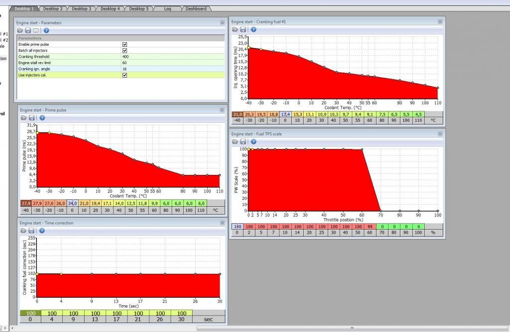

These are mine.
4 cyl 2.0 l turbo cosworth.
Starts very good cold ( whitout throttle ).
This engine needs rich fuel to start !

Thanks a lot!
@PBU
Which Injector size do you use? I have 580ccm
PBU
Posts:134
Re: startup parameters SR20DET, 2L 4Cyl.
Post by PBU » Tue Jan 06, 2015 12:06 am
411cc
Post by PBU » Tue Jan 06, 2015 9:43 am
bmwmaster wrote:Also maybe check your idle valve position. It must be open while cranking especially without throttle.
Correct. I have this setting also to 90% while cranking.
