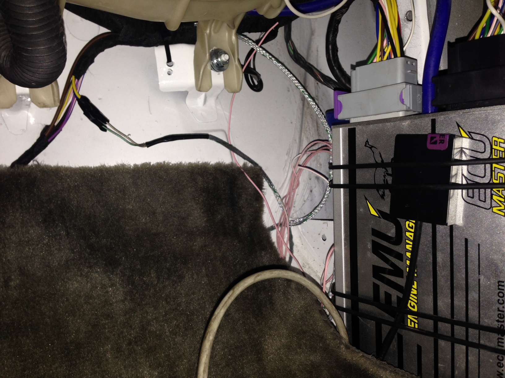

hi to all i swap the wires and still don't have egt readings? i have a small 10cm copper cable from emu to sensor and the other one to sensor ground.
thanks

Post by ktsirigotakis » Mon May 11, 2015 11:45 am
i still don't have egt signal in emu please see the pic, i have approximately 10cm of copper wire from egt plugs to emu plug
