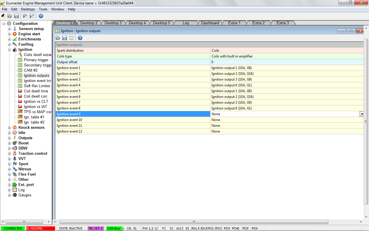

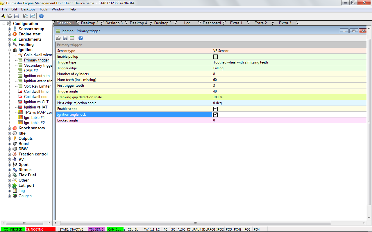

I have this setup in ignition :
8 cylinders
60-2 trigger
Ignition events
8 events - 2 x 4 ch. Coil amplifiers connected in wasted spark config, Firing order is hardwired correct to output 1-2-3-4 so ,Output 1 = cyl 1-6, Output 2 = cyl 5-3, Output 3 = cyl 4-7, Output 4 = cyl 8-2
1 Coil output 1
2 Coil output 2
3 Coil output 3
4 Coil output 4
5 Coil output 1
6 Coil output 2
7 Coil output 3
8 Coil output 4
Does anyone have an idea of what is going on here ? or anyone running a V8 with COP and has a file to look at ?

rene325
Posts:8
Joined:Thu Feb 26, 2015 10:02 pm
Re: BMW M62B44 Fueling problem

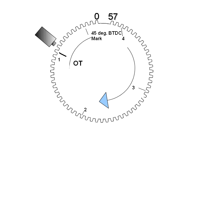

Post by rene325 » Sun Mar 29, 2015 2:52 pm
Hello Jadzwin,
thanks for your time and effort.
I have been trying a lot of configurations. Here are the one I have tested today, which, by my knowledge should work.
I have trigger wheel configuration drawing, ECUMaster primary trigger setup, Ignition output setup.
When crancking the engine with timing light I have theese observations :
Cyl. 1+6 ignites at point 1(OT) and 4
Cyl. 3+5 ignites at point 2 and 3
Cyl. 4+7 ignites at point 2 and 3
Cyl. 2+8 ignites at point 1(OT) and 4
Can you explain me why, from the setup ?
Regards
Rene
Post by Jadzwin » Sun Mar 29, 2015 5:30 pm
Are you sure your ign. modules wiring is correct ? Are you sure that you correct determine cylinder 1 ?
Your setup looks correct but results sounds like cylinder wiring problem. You wrote that you use ign. out 1,2,3,4 but in configuration you use 1,2,3 and 6.
Tommorow I will put your settings on simulator and check what is going on.

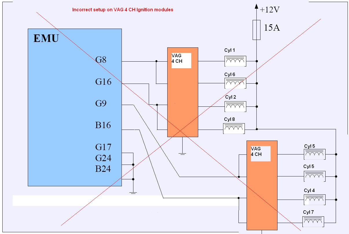

Problem solved !
Car runs great now with ECU Master.

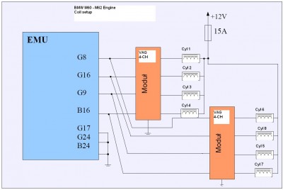

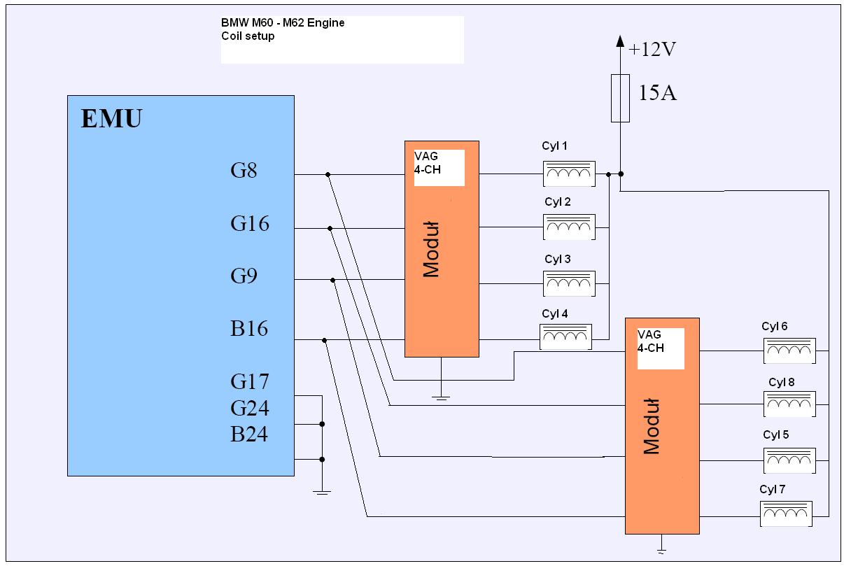

Problem was solved by rewiring ignition modules. I have included drawing of incorrect and correct wiring of the ignition modules.
I guess the VAG modules was never designed to fire 2 channels at once, so the the result was unstable triggering.

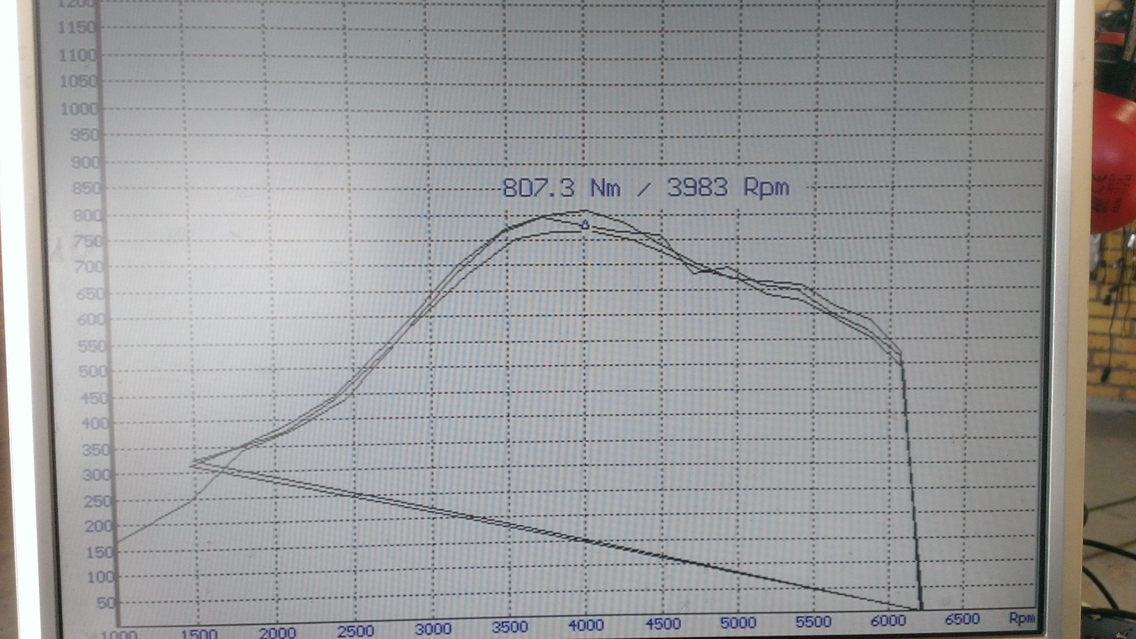

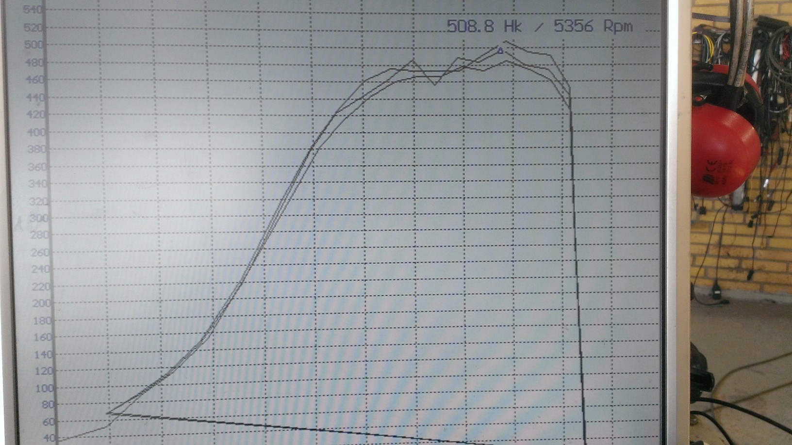

Final Dyno run (0.8 bar Boost controlled by ECU Master)
Thanks for inputs and help.
Regards
René
Engine Torque NM
Correct setup
Incorrect setup
rene325
Posts:8
Post by rene325 » Mon Apr 06, 2015 5:56 pm
And Horspower figure
Engine HP
