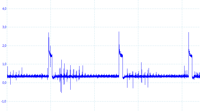

We have some problems with a Nissan CA18DET engine. the coils will not spark.
The coils need ground from the ECU, but gets + (see pic).
We use the Nissan trigger, and all wire is okay
hope some one can help.

signal cyl. 1.png (9.94KiB)Viewed 4295 times

Change coil type in Ingtion / outputs to coil without amplifier.

We have trying doing that, but there is no change

Can you send the log file and scope file ?

We have fix the problem.
I have forget to connect the power ground cables,
