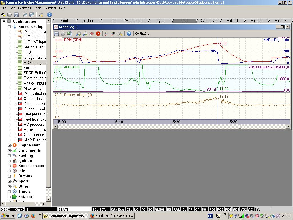

My Batterie Voltage has a 18volt at high RPM is this a Problem?

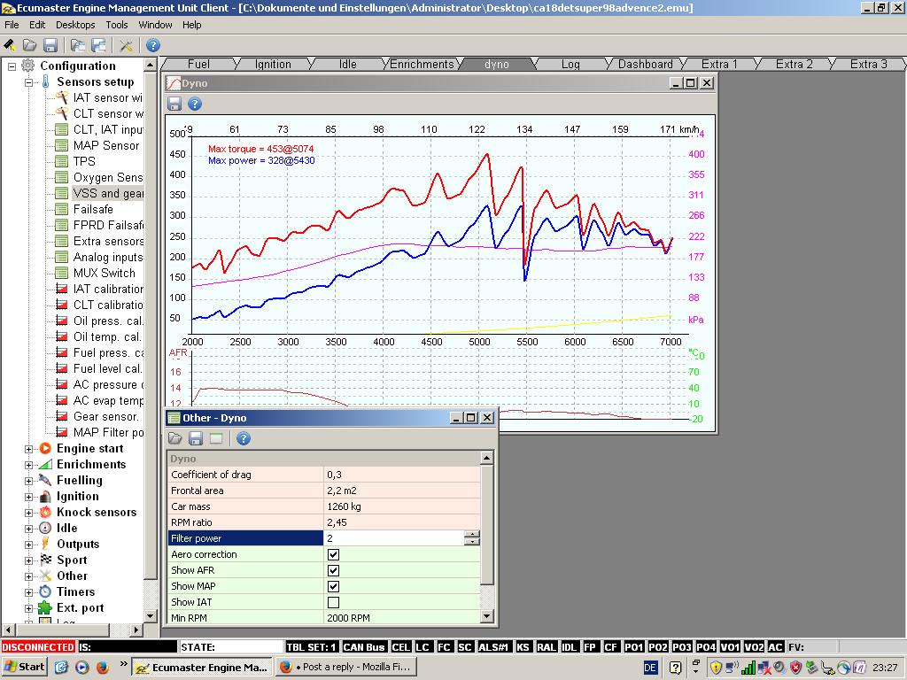

Next problem ist bad dyno log.
Whats a problem on my car?

Post by Jadzwin » Sun Jun 07, 2015 4:22 am
Use higher filter value for dyno.
For battery voltage you should fix your alternator (voltage regulator).

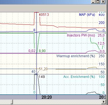

I have a next problem.
By crusing about 2000-3000rpm have a bug.
See my log.
Anyone a ideas?
20150718_2157.emulog
(984.39KiB)Downloaded 100 times

Post by gregpe » Sun Jul 19, 2015 4:21 pm
look like wiring problem shorting 5v to sensor ground or to ground you looking all reading tps voltage analogue and triggers... check your wiring
Re: nissanCA18DET
Post by Jadzwin » Tue Jul 21, 2015 4:30 pm
Was the engine worked correctly ? Looks like communication problem

Post by eugen_troll » Tue Jul 21, 2015 8:03 pm
Jadzwin wrote:Was the engine worked correctly ? Looks like communication problem
eugen_troll wrote:I have a next problem.
See my log.
Anyone a ideas?
Engine works correct, but over this bug 1-2 second is engine off. Sometimes is Tacho over this bug also dead.
Enging going thereafter not in Afterstart.
This bug i watching only in crusing speed, never WOT.
Without a computer is the same.
thx
Re: nissanCA18DET
Post by Jadzwin » Tue Jul 21, 2015 8:07 pm
I will investigate it. What FV do you use ?
