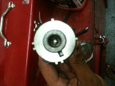

The M16A Sport crank trigger type is as like as Subaru WRX 36-2-2-2,but the cam trigger type is like my upload photo.
Looking forward to the new firmware update to support Suzuki Sport M16A,because we want to use EMU to tune on our M16A Sport,haha!
M16A CAM trigger tooth
