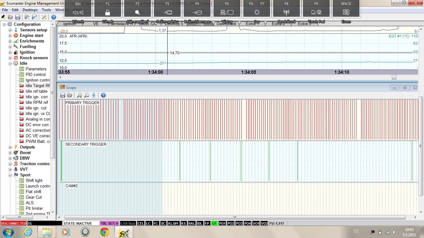

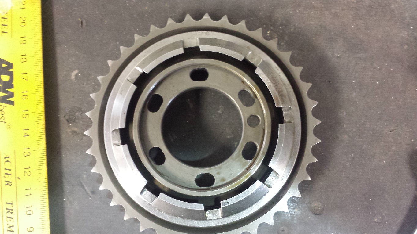

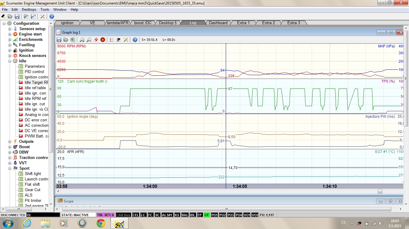

hi
i have s50b32 turbo non vanos ,i used for intake tothwhel of s50b30(exhaust) and   jadzvin advised me
remove three teeth,and use misingtoth
Tried here as the Hall sensor,as well as VR, But I still have the same problem
the engine is not running well, so when you add gas misfires!!!
Any ideas
THX

Re: s50b32 cam sync problem
Post by Jadzwin » Tue May 05, 2015 7:53 pm
Looks like signal noise from cam sensor.
You can try 2 missing tooth decoder.
Hoever I think the only solution is to disable cam sensor over 600-700 RPM

Jadzwin wrote:Looks like signal noise from cam sensor.
tried HALL sensors connected here, and VR
but interference with VR was smaller
trigger type I tried them all, but either did not start or still the same problem
Tomorrow I'll try to disable cam senzor
thanks
Post by Jadzwin » Tue May 05, 2015 9:53 pm
Actually to fully diagnose the problem you need to use scope and check the signal shape, noise and so one.
Post by PSI-Motor » Tue May 05, 2015 11:22 pm
I used the standard VR Sensor with Hall and pullup settings. Works perfect. Do you use a sheilded cable all the way?
If you are not planing on running Vanos you can just disable it över 600rpm.

Post by mmt » Wed May 06, 2015 12:58 pm
PSI-Motor wrote:I used the standard VR Sensor with Hall and pullup settings. Works perfect. Do you use a sheilded cable all the way?
thanks
yes I used bmw oem cable from vr sensor , with shielding
I plan to use without vanos
