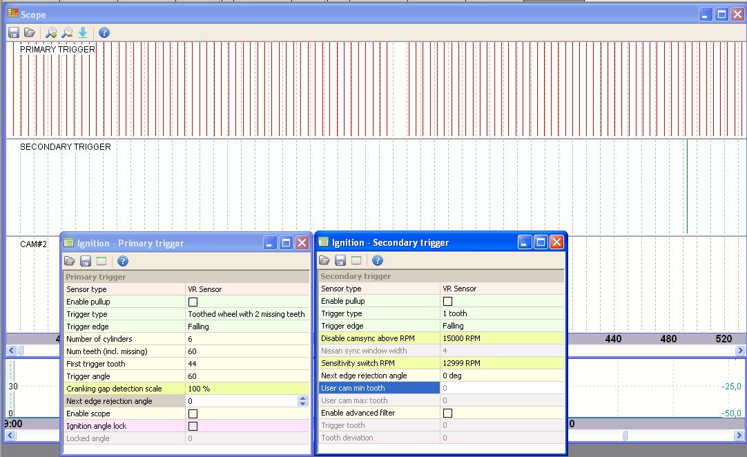

Hi Guys
When driving at low rpm I sometimes gets a misfire, have found out that I have strange trigger signal. Do you have any ideer why ?
The engine is a BMW M52B28
The crank and cam sensor is both VR from a M50 engine
The car runs fine and pulls clean, its only during low rpms

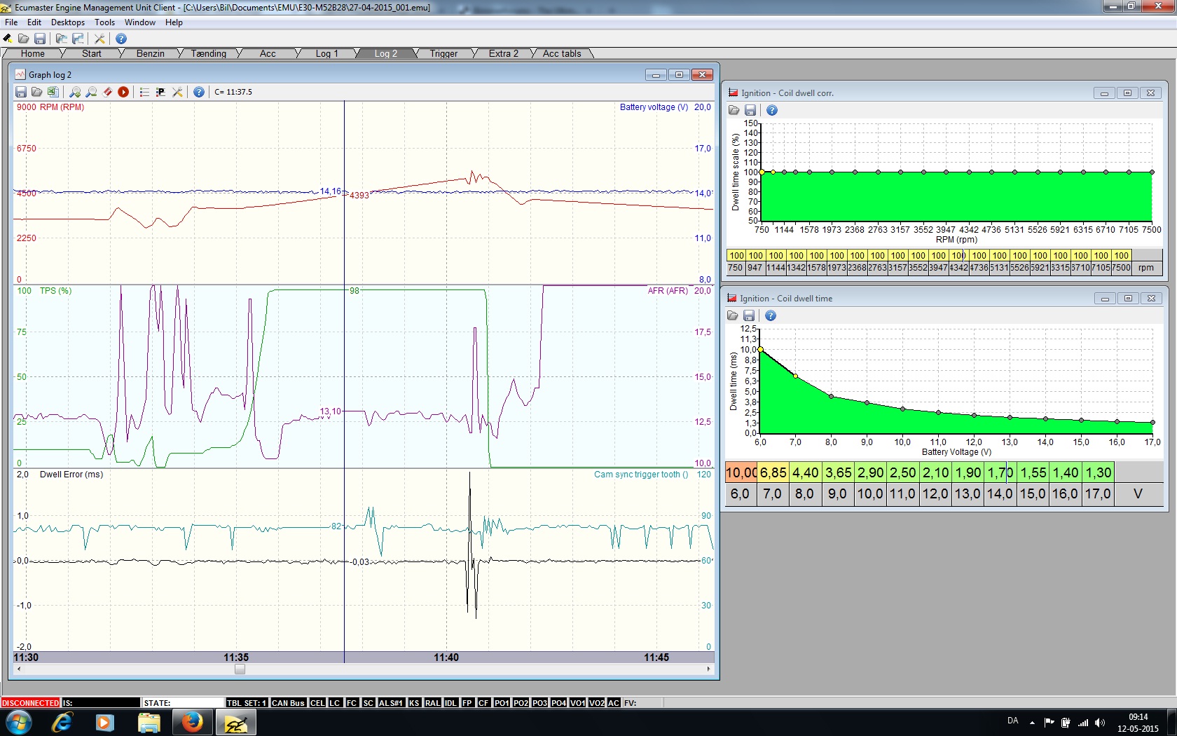

Hi Jadzwin
Can you explain how dwell error is messured. I just got the same error at high rpm also, but now I dont see the cam sync trigger tooth at the same time
The coils are 0 221 504 004 (M52B28)
The dwell time is 1.65 @ 14 volt
11-05-2015_001.emu
(77.98KiB)Downloaded 105 times
Re: Cam sync trigger tooth question
Post by Jadzwin » Tue May 12, 2015 12:05 pm
The dwell error is the difference between required dwell and real dwell. It could change due to cranks shaft rotation speed change (dwell is issued one revolution earlier) or trigger errors.
In your situation the cam sync trigger tooth could be stable (+/- 2 teeth)

Hi Jadzwin
Thanks, so it's just noise on the signal ?
BR Lasse
Post by Jadzwin » Wed May 13, 2015 4:27 pm
Looks like noise..

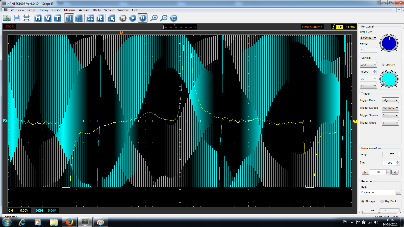

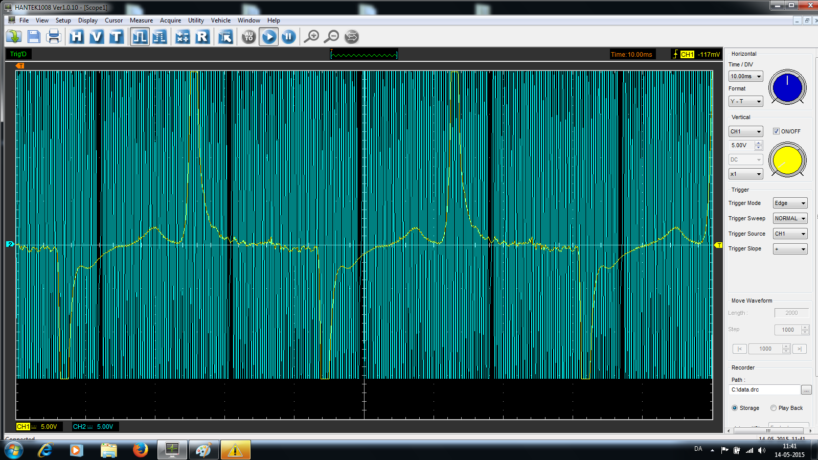

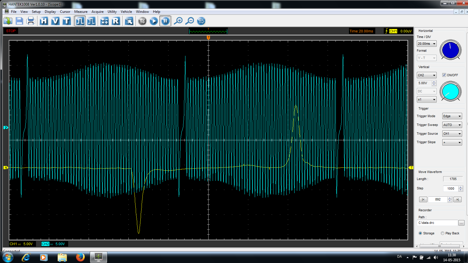

Hi
Just made a few logs with a scope, it look ok - right ?
aprox 3000 rpm
aprox 2000 rpm
Idle
