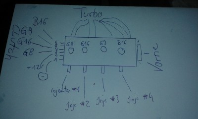

Re: ignition problem Opel Z20LET
here I still have the connection diagram
and scope
and scope
