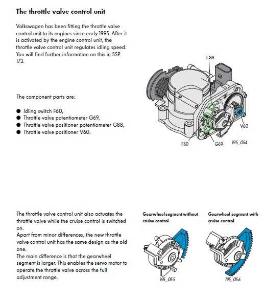

Hi!
My project Audi 2.2t AAN.
But it does not have a stepper motor idle.
I thought to put the throttle on the audi 2.4i
I do not know how to connect it.
I enclose a scheme throttle
Thank you

EMU doesn't support this kind of the idle control. So you need to use eg. PWM valve or install full electronic throttle.

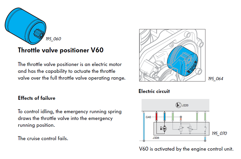

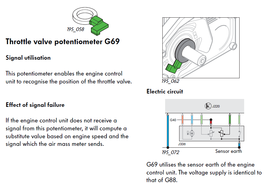

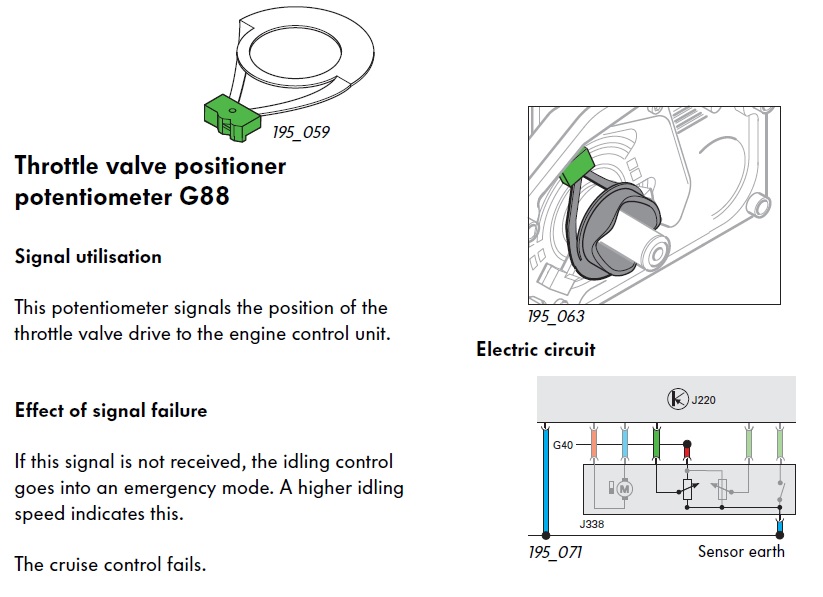

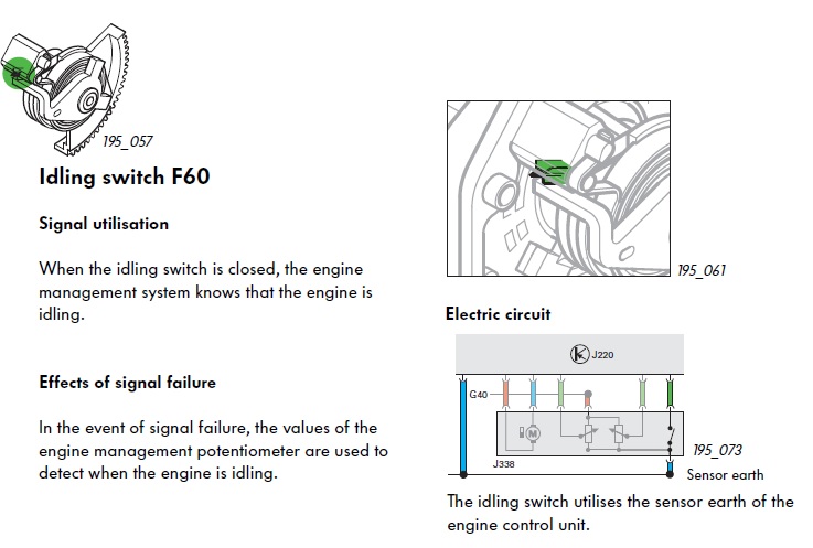

you can use for the aan the original throttle body and tps with the external idle valve.
or you go for the passat, a6, a8 electronic gas pedal and a full electronic throttle body.
SSP_210 elektronisches gas pedal.pdf
(1.69MiB)Downloaded 118 times
