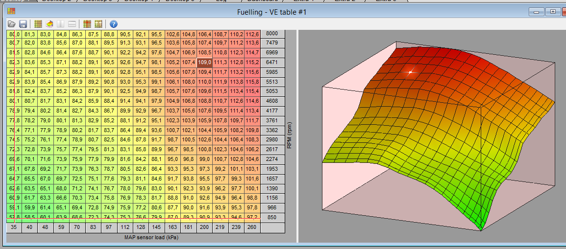

Hi, I encountered a problem with my turbocharged engine (SR20DET) with a PWM Idle solenoid. I calibrated the Charge temp. estimation Table to 0 everywhere, as I did not know which numbers I should estimate... I have tuned very excessively for an acceptable VE Map (advanced lambda fueling model) for my engine for many days with approximately the same outside temperature. At the end, engine response was nice, Lambda not too far away from target lambda, and Idle was stable at lambda 1 for about 1 minute after driving. Then engine started to oscillate around the Idle speed, with lambda oscillating with the engine from rich to lean, but I could not do a thing against that.

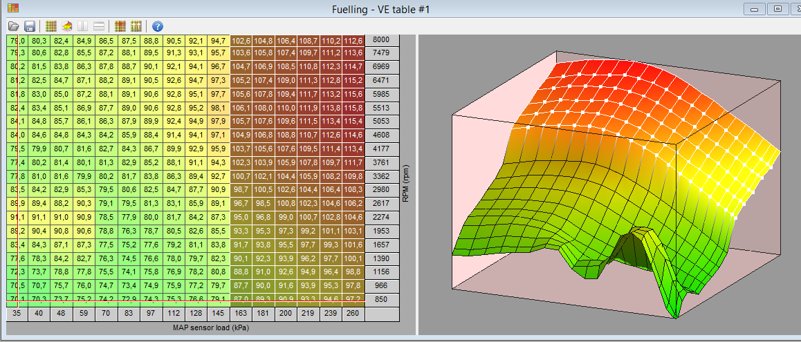

One nice day with about 10 deg Celsius warmer outside temperature the whole VE map in low partial load was not correct anymore (did not test higher loads). I fought this engine with oscillations in Revs from almost stall to 1800 and AFR from approx 12 to 16 for over 120 minutes idling until the lambda values became stable at around 0,96 to 1,04 and revs calmed down to 200Rpm oscillation. (to be mentioned here, I tried Ignition control, PID control and both DC and Ign error correction table to fight oscillating engine speed, but nothing seemed to work really good...)
Please take a look at the low rpm and map part of the VE Maps. In the heat soked map, the low numbers after the high plateau are correctly tuned to lambda 1!!!!! is that possible to be the true VE or would a good Charge temp estimation solve that problem?
How do you guys get rid of lambda drift in different environment conditions and heat soke (and oscillating idle)?! Btw I have to pass an emission test in one week :?

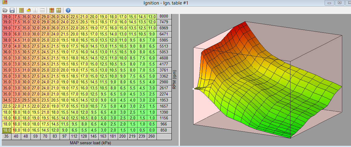

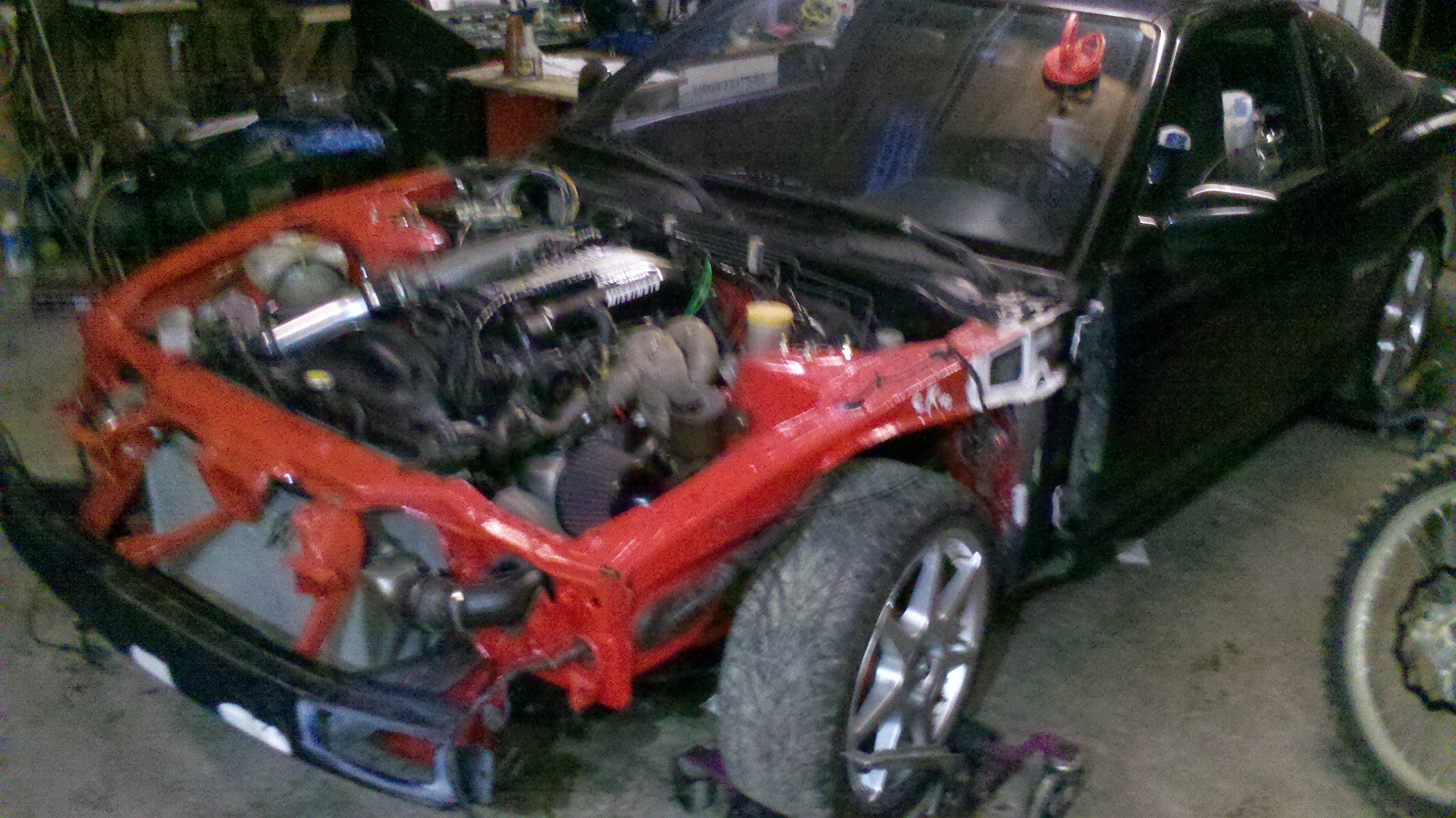

Hi, timing is at 18 deg in the idle area. My IAT sensor is mounted in front of the engine bay: under the headlight in the bend of the coldpipe. Sorry, I dont have a better/newer photo. What I just found is, that I had an IAT correction of 97% when Idling was that bad. I adjusted it now to 100% and will see if that makes it idle better.

Post by MrBmw » Tue May 19, 2015 8:35 pm
Hi!
Try to lower your timing at idle to 5 deg, low timing at idle usually makes it run mush smother.

Post by clem » Tue May 19, 2015 9:19 pm
Ok now as you say it, lowering the timing would make life easier! I use Nismo 740 Injectors with 95 Oktan fuel.
