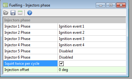

Re: BMW M60B40
Nice! Thanks!
So, if we take the firing order 1-5-4-8-6-3-7-2 and the coil and injector pairing is:
1 with 6
5 with 3
4 with 7
8 with 2
How would look like the inj. phase table?
-Like that?
1 with 6
5 with 3
4 with 7
8 with 2
-Like that?
