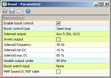

by Marab
This setting is ok for the valve (MAC) supplied with EMU?
